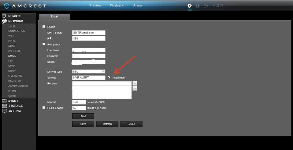

The problem its with the NVR.. When i configure the NVR with all the instructions I have been able to find.. I do get an email alert but it does NOT include a snapshot of the motion i get the alert with out any pictures..
Here is how i have the NVR setup
Under Network>email. Next to the subject line it the attachment check box and i have it check

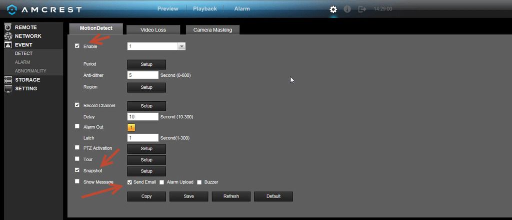

Under Event>Detect>
cam 1
Enable its checked
Snapshot its checked
send email its checked
I do get an email but no snapshot..

Click on the 'setup' tab next to snapshot under Motion detects settings and make sure snapshot is enabled for motion recording. Also go to Storage > Schedule > Snapshot and ensure snapshot is enabled for motion detection. Tyr again after this and see if you get snapshots with email.
