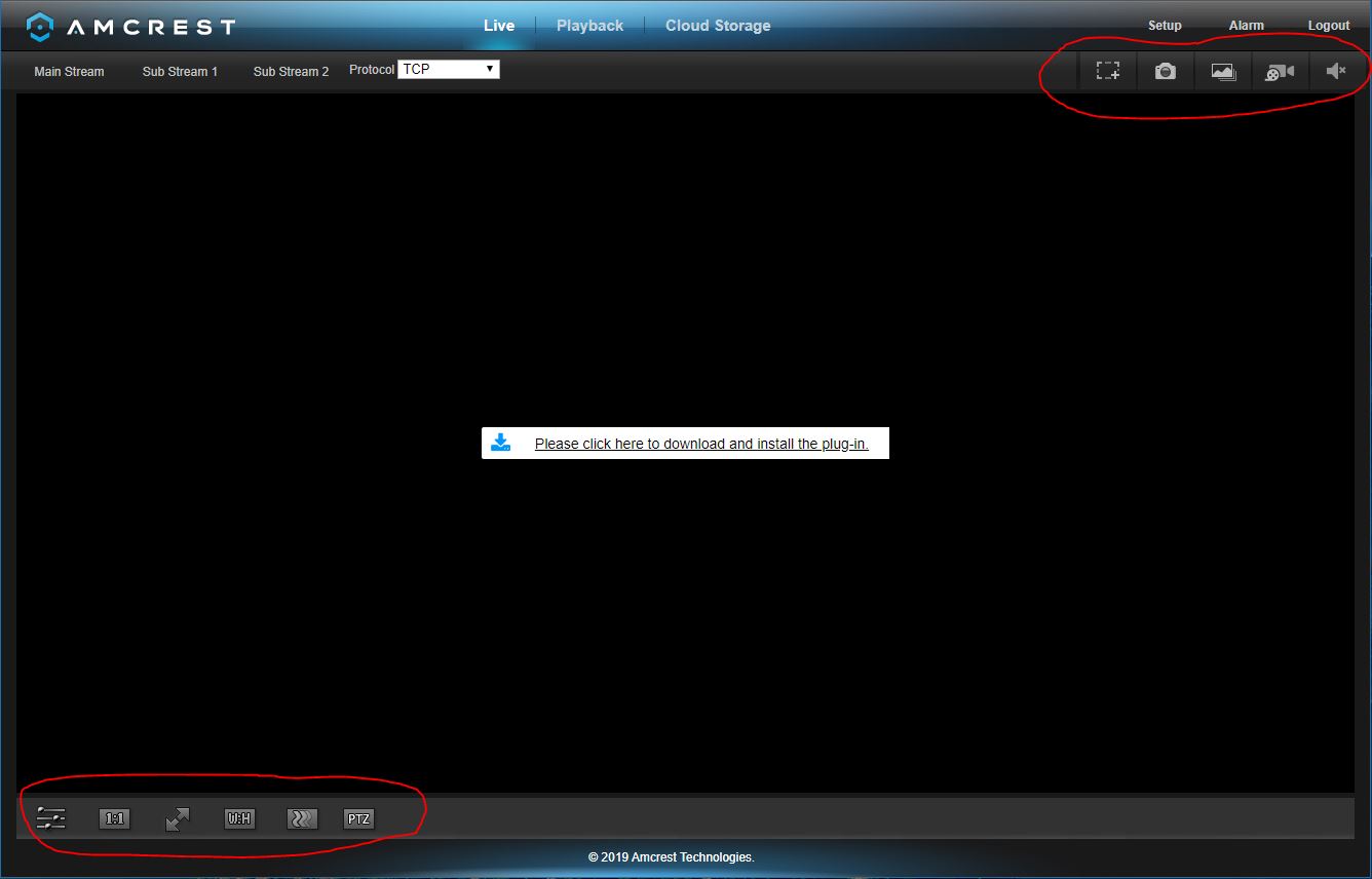

I received my IP8M-T2499EW and noticed with the original FW that it came with (2.622.00AC000.0.R Build Date: 2019-04-15) it asks me to install the plugin but when I click on the link it just show me directions how to install it. So when I search for Amcrest Web View in the Chrome Web Store there is no results shown. So I updated the FW to the latest version and now the camera loads the live view BUT I am missing all the features in the bottom left and top right. Now what do I do? The screenshot is what it looked like before the FW update.
