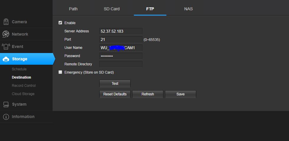

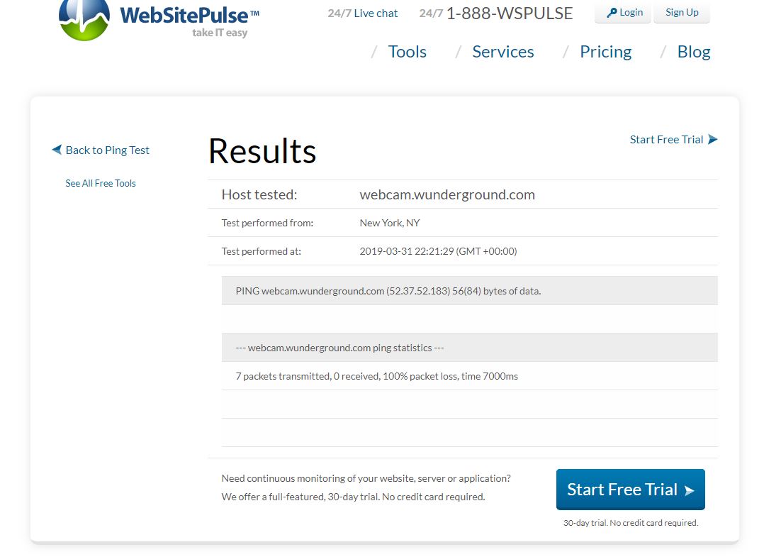

Any chance you could post a screenshot of the settings on the different screens that you use? I think I have it set up correctly based on a ping of the webcam.wunderground.com address, but it keeps failing.Skijackz wrote:Hi Brcruisen:
I setup Amcrest to send a picture to WUnderground via FTP. Only issue is that Amcrest doesn't accept an URL for an FTP so you have to find the IP address for webcam.wunderground.com. That's pretty easy using PING but here it is just in case you need it. 54.148.11.142. Note that if your camera goes offline, check the IP address for the webcam before doing anything else. WUnderground can change it at any time.
It would be nice if Amcrest would update the software and allow URLs for FTP sites. Then we wouldn't have to worry about WUnderground changing them.
- Ping Screenshot
- Ping screenshot.JPG (74.98 KiB) Viewed 1673 times
- FTP Screenshot
- Screenshot.JPG (37.07 KiB) Viewed 1674 times

Ah, ok. That's good to know. Thanks.plusfour wrote:Note that WU are currently in the middle of a rather painful upgrade from their old code base to an entirely new code base, and many things aren't working as expected. If you find you're having problems you may want to wait a few weeks until things are going a bit better for them.
I thought that maybe based on the 100% packet loss from the ping test that maybe the site was down; however I'm not at all familiar with ping data.
