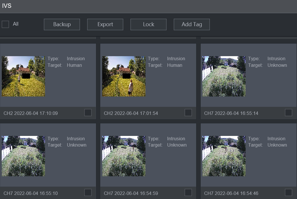

So I can't say I have seen the WebUI of an updated unit yet however I thought I would touch base on some things I think may help others that are looking to buy one..
As I have said in another post somewhere the 4108E-A2 and the others in the A2 format work in AI mode only with AI type cameras.
So lets say you installed a couple different types of cameras and here will be the results. For now I will say the Amcrest 1046EW-AI camera and 2496EW-V2
You setup the cameras to use IVS with Tripwire and or Intrusion. When you get an event from the 2496 it will not have a know type of trigger however when the 1046 setup with IVS it will in the search from the NVR give a result of what type of event triggered the IVS rules..
So in the top left 2 you can see there are human as the event type however in the rest they say unknown that is a 1046 (True AI camera VS a 2496v2 that has IVS however no way to tell what it is) If you were to use a Amcrest 4216E-AI NVR or one with in the AI family it will use the info from the Amcrest NVR to know what the event type is and can even use 4 channels for AI on the NVR with out using a AI camera.
