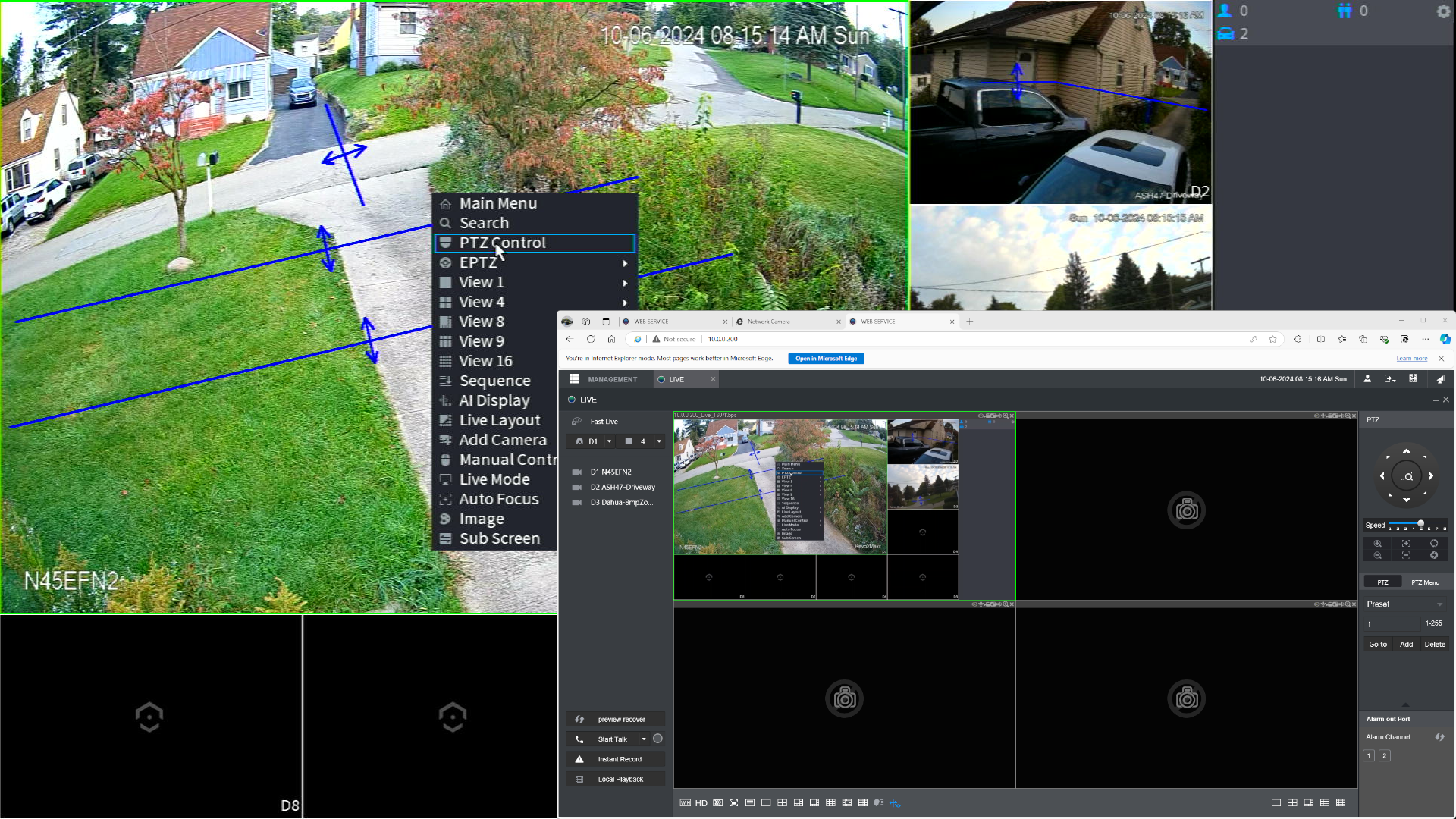

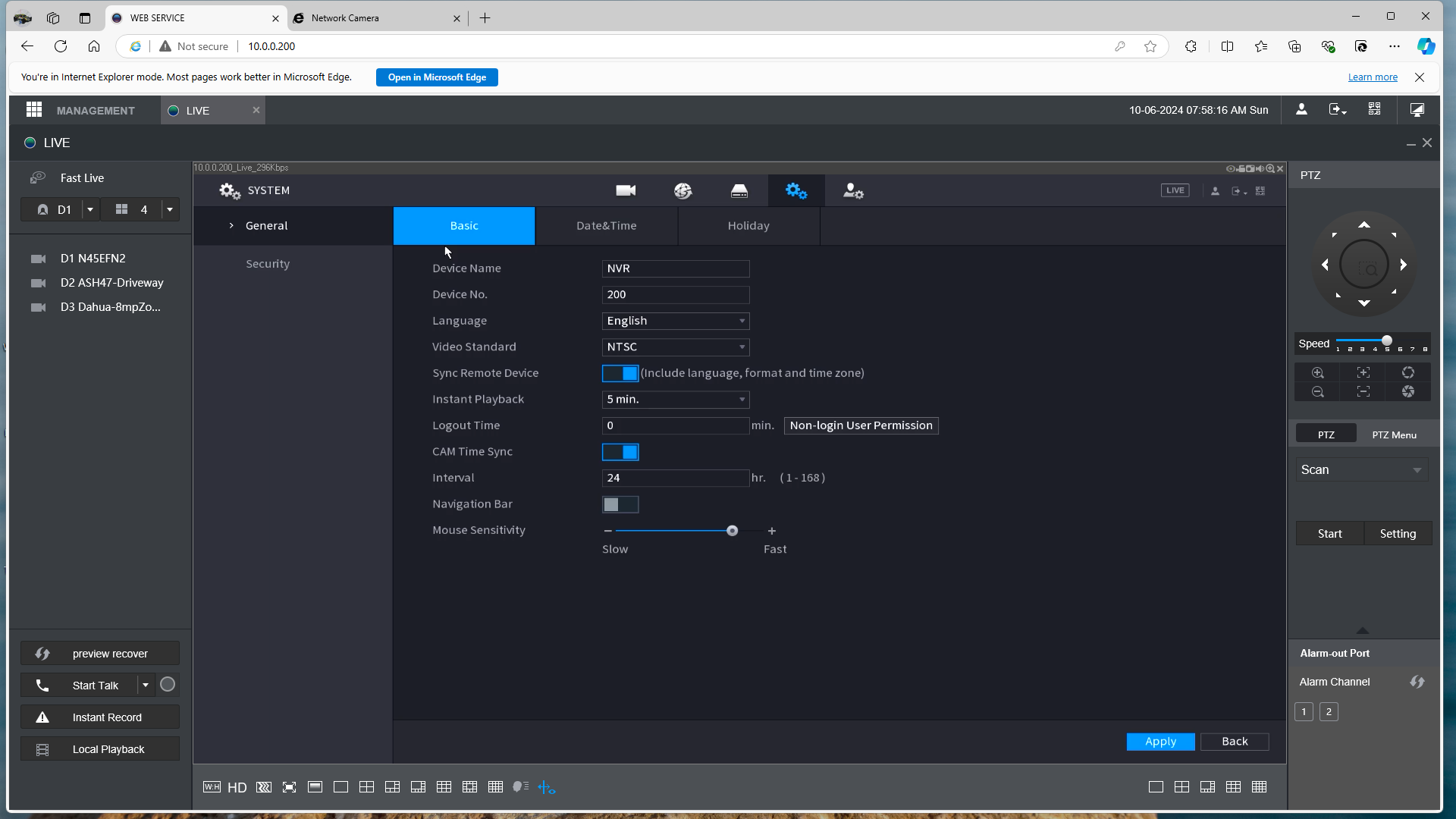

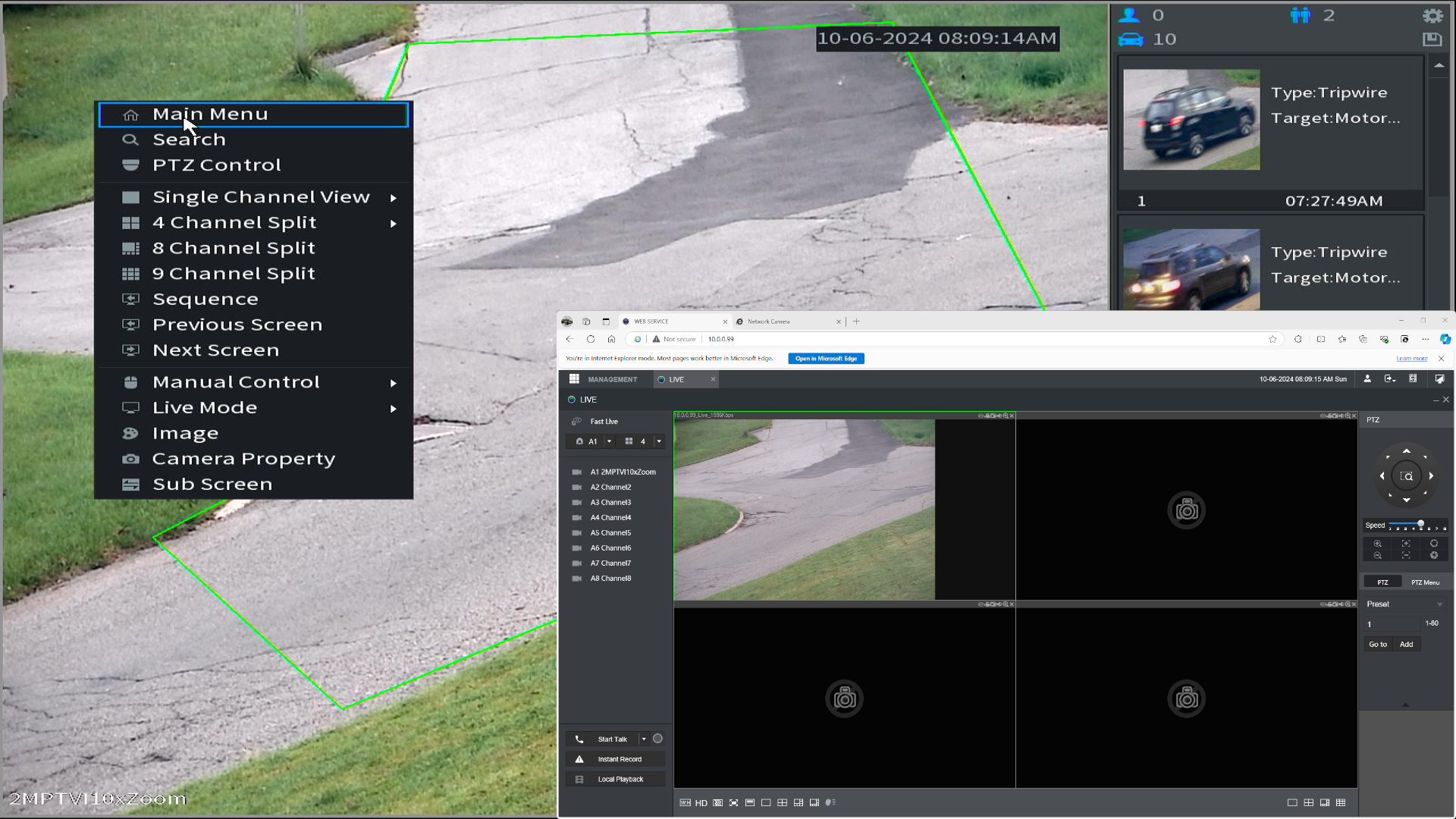

So I wanted to be clear, The 7108-Ai DVR and my 5108-E1 both offer Zero Channel enable and Disable ability, However my 4216E-Ai and my 4216-E1 don't offer the disable for Zero Channel. 1 other issue that I find is that my DVRs while they will show the display of the output from Zero Channel for the cameras that are connected you can see in the pictures below that the DVR don't show menu and seeing you can not only see the Menu of the NVRs you can see all data that is being entered once the menu is opened..
DVRs WebUI using Zero Channel NVRs WebUI using Zero Channel next 2 pictures..
