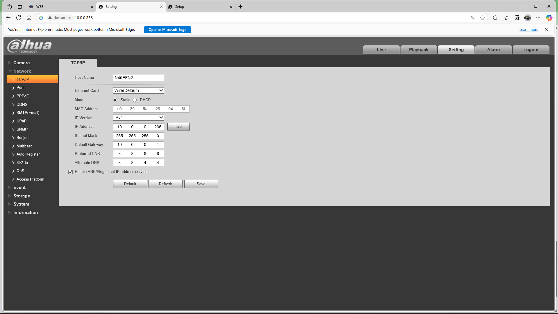

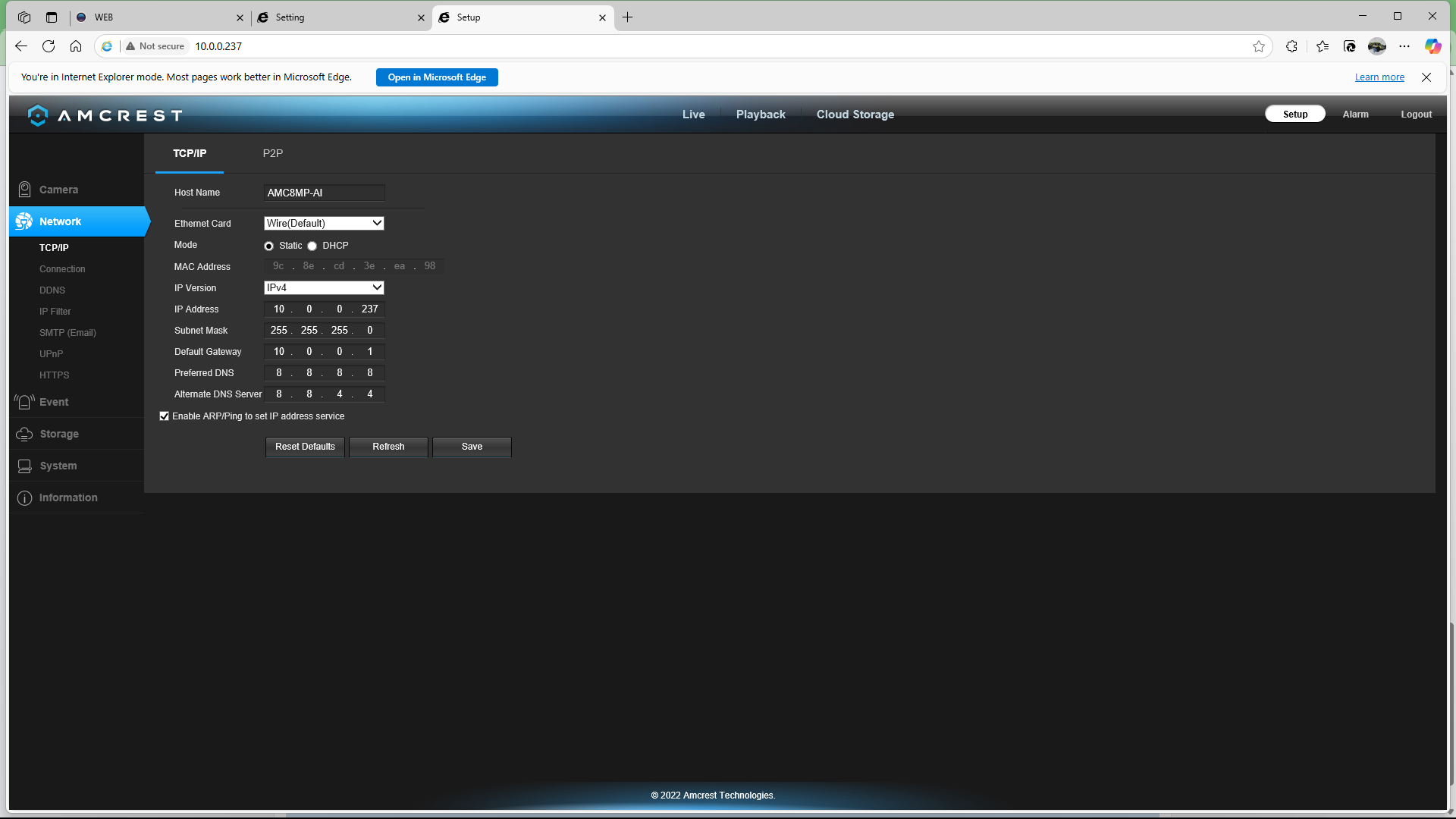

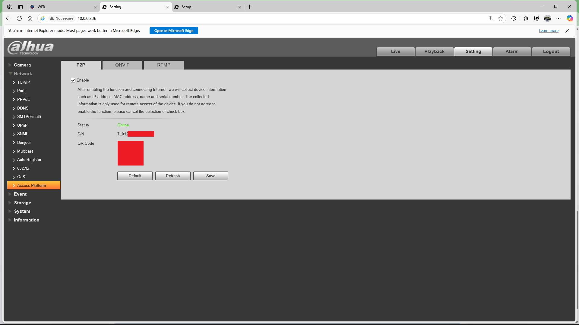

So using the WebUI log into the camera, Then go to Setup, Network, and then Access Protocol and make sure that itis enabled.. Next need to make sure that the DNS points to a good DNS server. I use googles 8.8.8.8 and 8.8.4.4. Then also need to make sure that the IP info is working and correct for IP on your lan to access the Internet. Don't Miss understand my intention.. What I mean.. If your network is on 10.0.0.xxx and your camera is setup for 10.1.1.xxx it will not have access to the internet because your router don't route that IP.. So good IP, Good Gateway, Good DNS and that the Access Platform is enabled.. If it is showing online then you will need to make sure to use the correct user and password..

Could not find "Access Protocol" in settings. as for IP`s and DNS looks okay I think

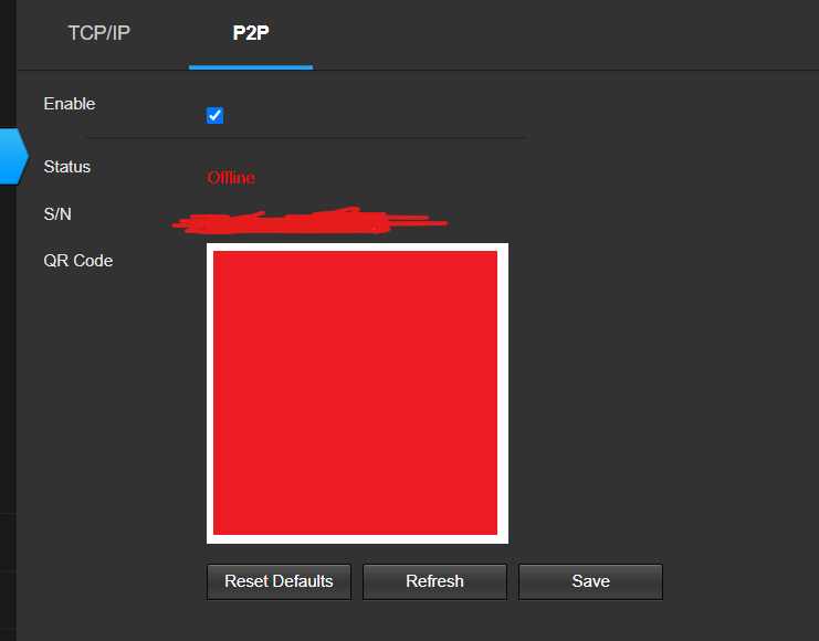

Just noticed P2P is enabled but status says "Offline"

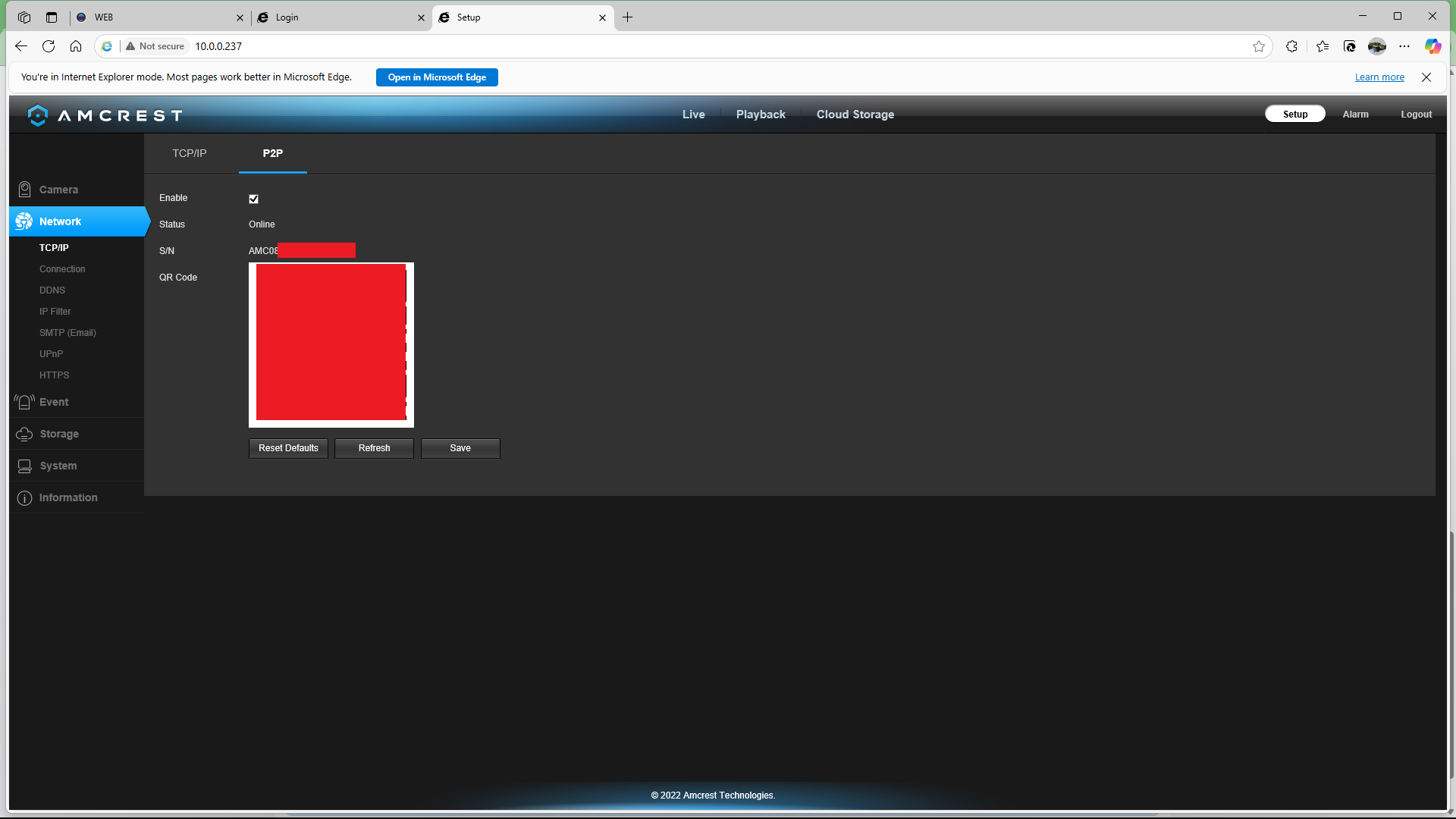

Yes sorry that is it. P2P under Network and on some TCP/IP and others it is just under Network on the left at the bottom. Access Protocol is for other systems that I have.. Sorry I forget sometimes what is what..
Re: IP5M-T1277EB-AI - Night vision LED visible?
So you are not alarmed I also fixed your P2P image. Don't need any trolls getting your SN from your QR code so I crossed it out for you.. I know your system isn't online yet but when it is you don't want trolls trying to access your system without you knowing about it..

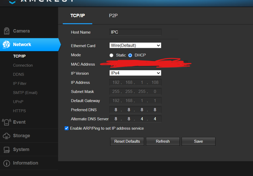

default gateway is 192.168.1.1
camera got xxx.xxx.1.108
and my PC is xxx.xxx.1.5 connected to same router as camera, via LAN
from web browser and amcrest surveillance pro software i`m able to use camera

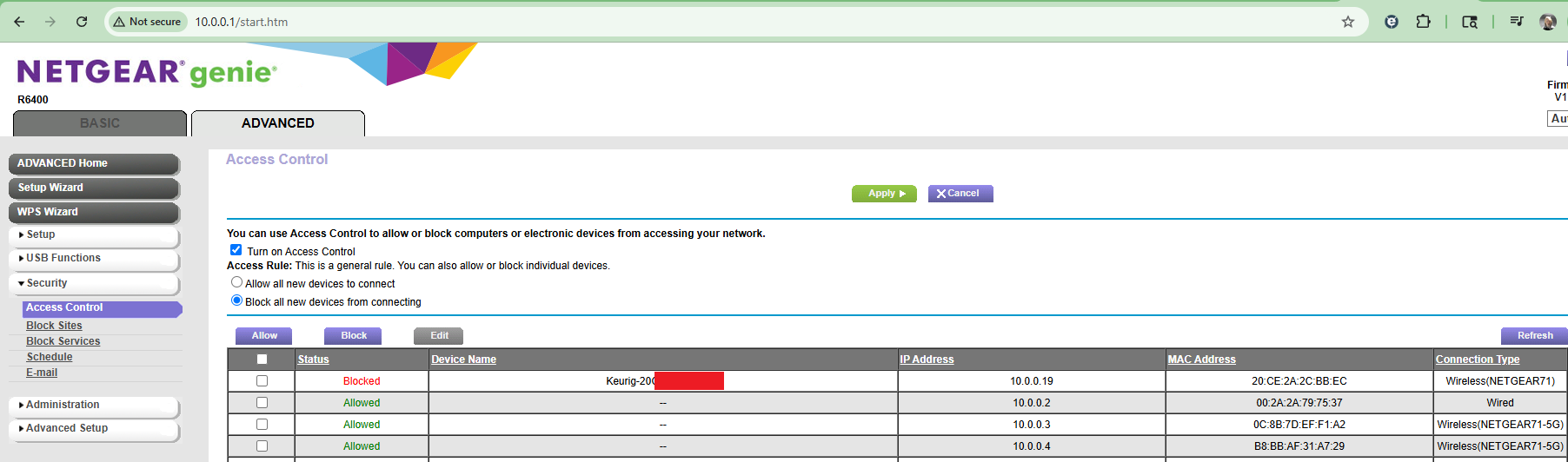

can you please screenshot or somehow show me how does the page look like where you give a certain IP an internet access in router settings? maybe i`ll be able to reach to ISP and ask them to check and possibly fix it for me

I doubt that is the issue with your setup. It would be that way for all devices. Meaning on my device anyway all connected items are blocked by default and I have to give them access.. So I Blocked one but it is normally given access to the internet I just wanted you to see what it would look like by default when I setup a device this also means every camera that I setup on my local network I have to give access to the internet.
This means if you were setup with something like that and you didnt have acess to the router your computer or your phone or what ever you have connected to the LAN wouldn't have access to the Internet unless you give it access..

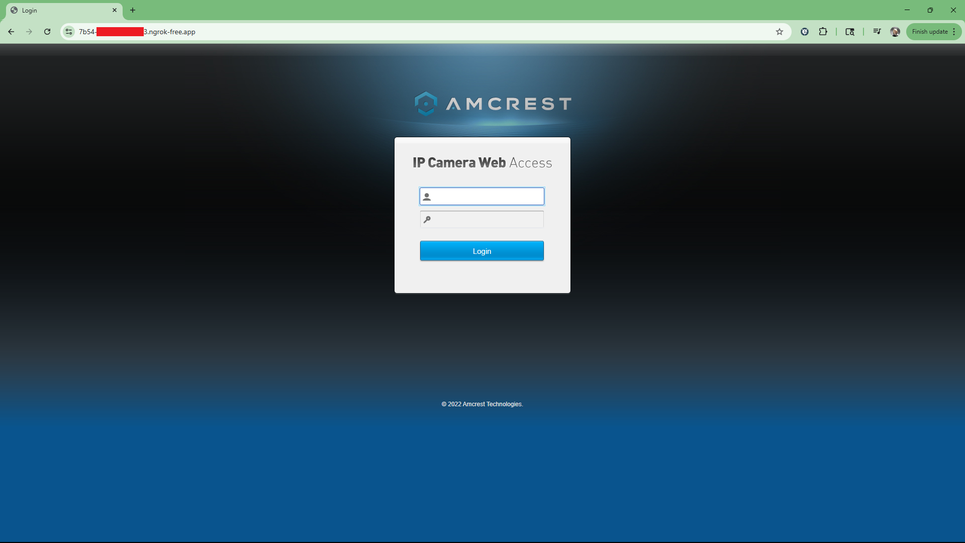

If you want to setup something to give you access now.. I would look into NGROK.. That is a tunnel service that you DL the app and access it, Then you type the command for your camera like ngrok.exe http 10.0.0.237 and this will give you in my case a https URL with my real IP address and some other info that when you go to this address you will be able to log into my camera..
But here is a picture.. Not all my devices but you get the general idea.
