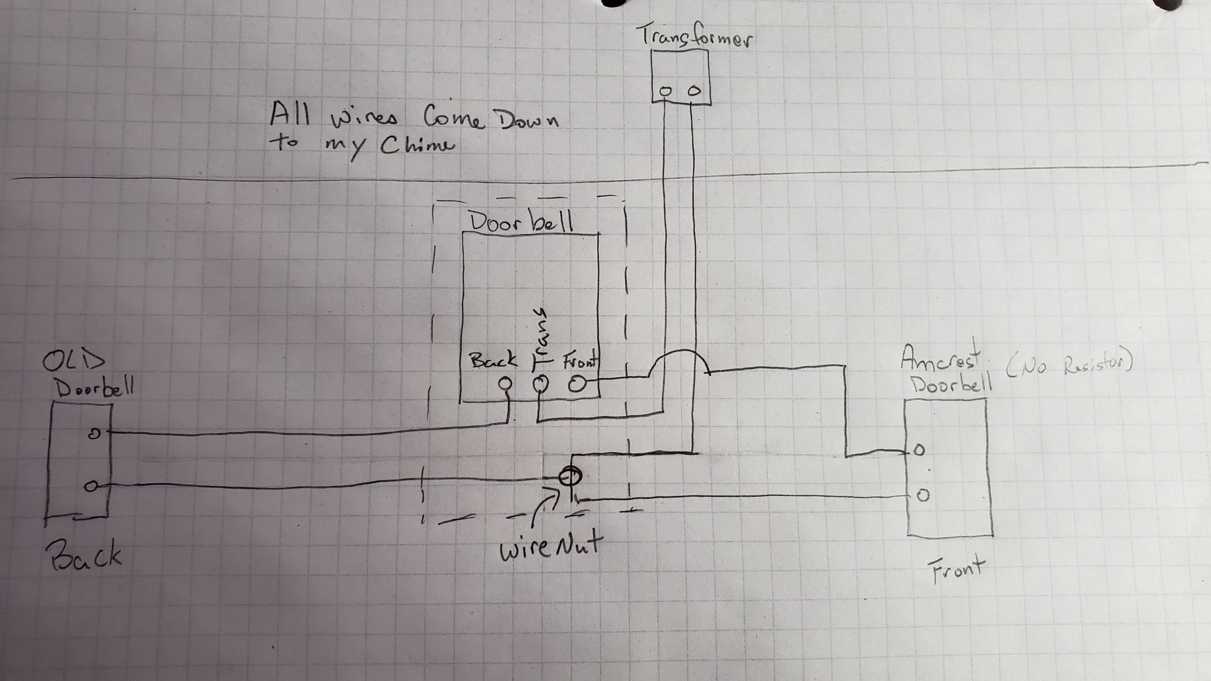

Update here.
I was finally able to get some time and work on the doorbell. I had a suspicion that they may have been wired incorrectly so I found a diagram with the correct wiring for this setup. When I checked to see if they were correct or not, I couldn't tell for sure so I pulled them all out and metered/toned my lines to make sure I knew what went where. I had 3 pairs - 1 pair transformer, 1 pair front door and 1 pair back door. I double checked how they should be wired. Sure enough, the wiring was not correct. Once rewired, everything worked fine without the resistor.
Then I noticed the new firmware today (rarely if ever do I use the app) The chime duration possibly could have helped me with the bad wiring but that's water under the bridge now. I am looking forward to see if the Nightvision toggle works since my camera faces a street light and constantly flips between day and night mode all night long.
Anyway, here is a line diagram of the wiring for a two button (front/back) setup.

Re: Video Doorbell CONSTANTLY chiming
Keep in mind, this diagram is only if you want two separate button zones like I have. This allows for two distinct chimes so I know which button is pushed. If you just cover one of the buttons in the diagram it'll make more sense and you can see how the circuit is completed.
