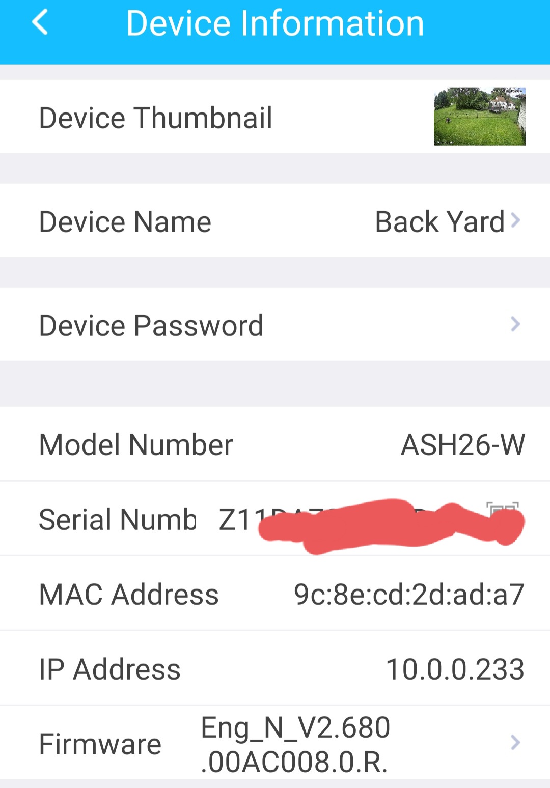

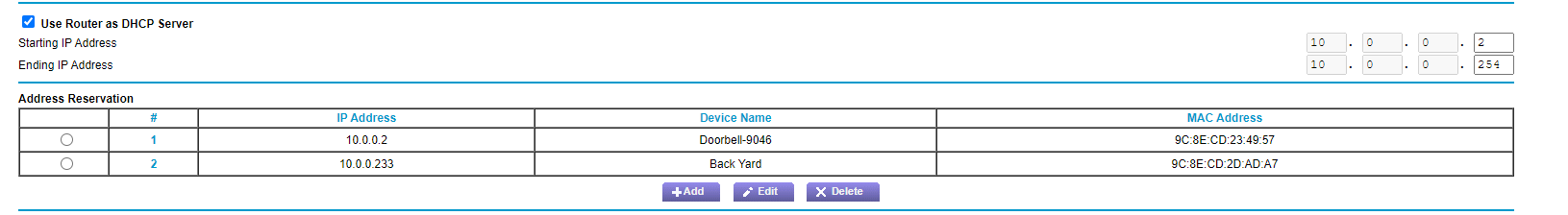

Hello, I came across this post while trying to figure out how to access the interface of my ASH26, and this post answered one of my questions regarding web interface configuration, which you can not do it sounds. I am trying to set a static IP on this camera and cannot figure out how. There seems to be no settings in the smart home app for network. You can only select the wifi network to join. I also tried using the IP config tool but it does not work either. There's only settings for the wired ethernet card, and the dropdown does not have the wireless card. Is it possible to set the wireless IP to a static IP?

While there might not be any access to the Lights IP address for setting a Static IP the good news is most not all but most Routers have that option built into the system. My picture is of one of my Routers that has 1 Doorbell, and 1 ASh26 connected to it. The Doorbell I left on a Lower IP for my reasons the Light I changed and it is on a Higher IP. Normally it was loaded in at 33. However I took it up to 233 please see the Lights picture showing IP both reflect the Routers Static Setting.. When you first setup your Router and it makes the setting, your ASH26 will need to be rebooted to reflect the new IP at least it was in my case. Then after every reboot or Power down the IP address will always be what is listed in your Routers Table...
