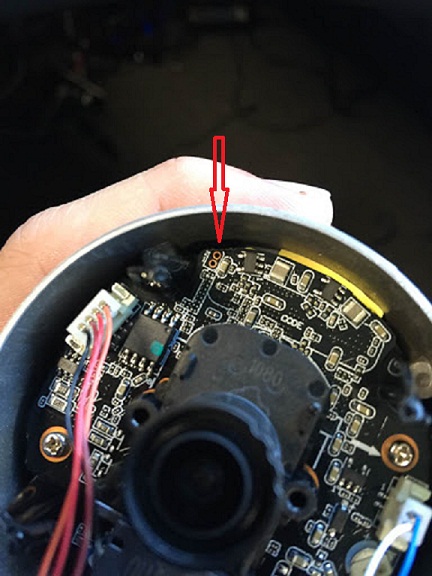

Followup request, Melvin... I have the same issue but cannot see an obvious location of the two brass ports to perform the reset with in the camera. If you could elaborate slightly on this, it would help me immensely. I do see what could possibly be identified as the two ports on either side of a two-pin connector (with red/black wires). That looks right if the top of the camera is the area that has the sliding cover (opposite the label). TIA

Hello LoneRider191,
You need to open the front cover of the camera with the IR LED board and inside of the main board, on the top left, you can find two brass ports as seen in the image below.Please take a wire and join the two brass ports together for 30 seconds. This will reset the camera.Please check the attached image.

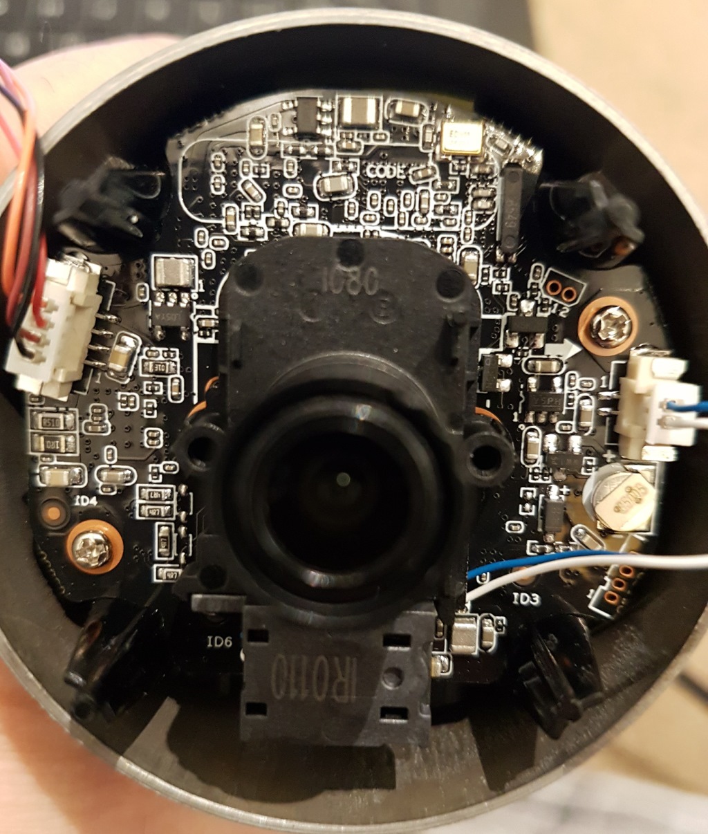

Our IP2M 842EB board does not look like the one shown by Melvin (see attachment), and a colleague changed (and forgot) the password and we're all stumped as to how to recover it? Any help would be greatly appreciated!

Hello drfonz ,
You can short the two brass ports (top right in your image) with a wire and it should reset it.

Post by LoneRider191 »
Quick confirmation followup. Yes, Melvin, my board is also like DrFonz and I also confirmed independently with Amcrest support that your are correct and shorting the two pins on the right side (per DrFonz' photo) does perform the reset. Still seems odd to me that there is no provision (anymore) to do this without having to actually access the camera's circuit board (but, what could go wrong there??!!... ;-)). Thanks for the help, very much appreciated.
