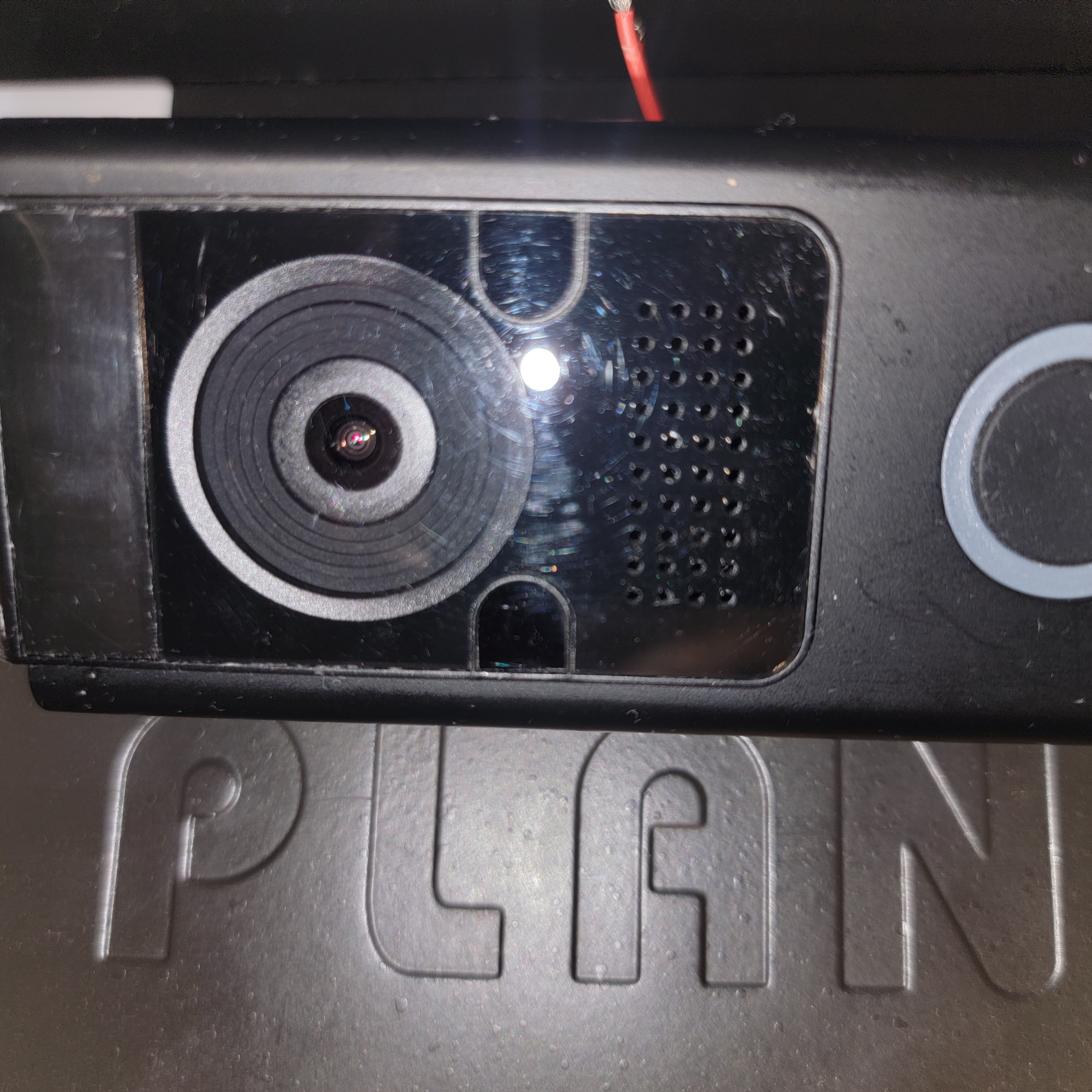

The sensor cover portion of the doorbell has cracked from daily direct sun exposure. The sensor cover was not made from the same doorbell housing plastic material. Has anyone experienced the same issue? Any suggestions on how to fix a cracked sensor cover? Thank you.

i recall the sensor cover was made from a softer, less rigid plastic material, which was different than the rest of the doorbell hard plastic housing. the rest of the hard plastic housing looks ok, even with daily direct sun exposure. does anyone know if Amcrest now ships the AD110 doorbell with a hard plastic sensor cover? If I get a replacement AD110 doorbell, and it still comes with the softer sensor cover, I'm afraid the sensor cover will crack again from daily direct sun exposure.

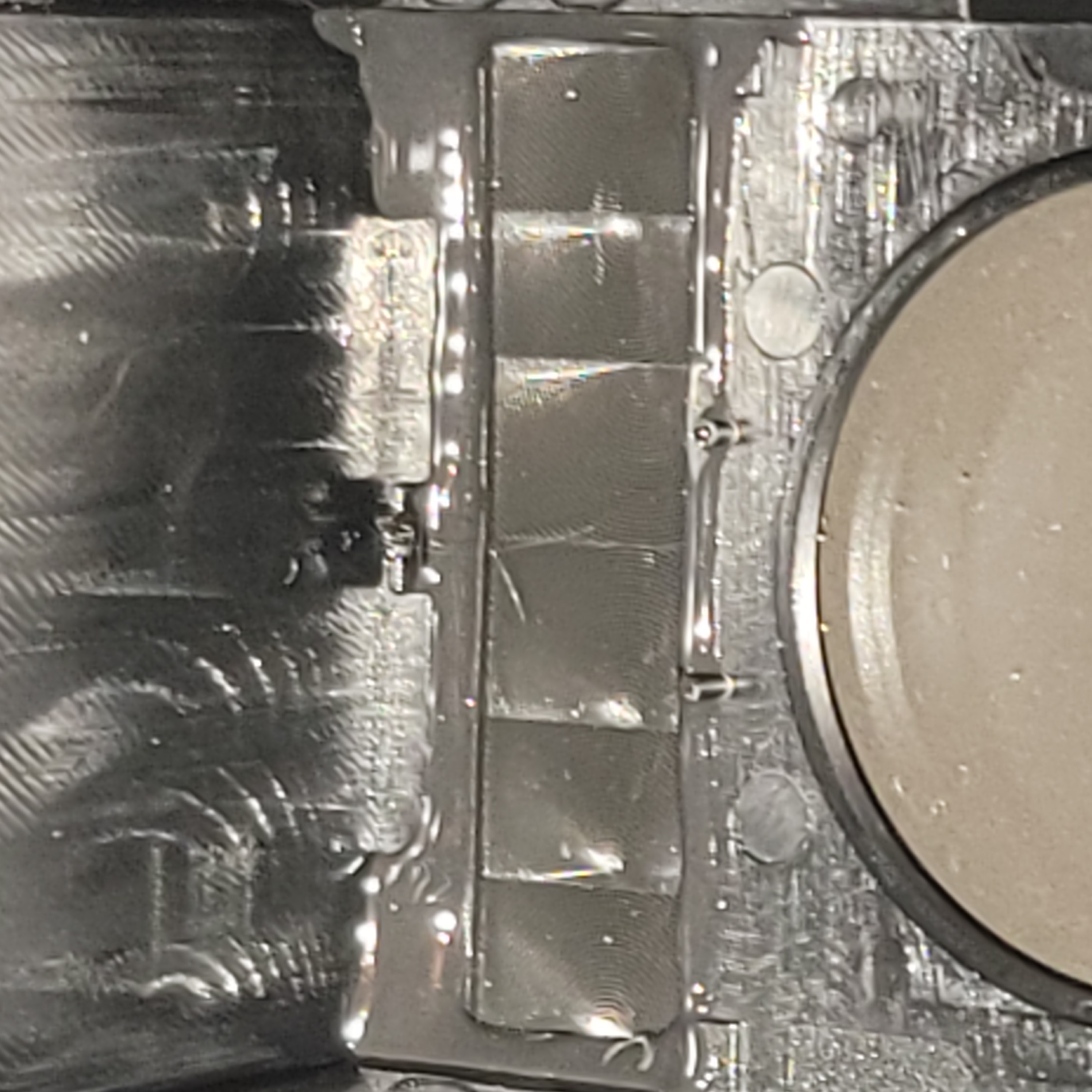

So not sure what replacement you got but me I would have swapped guts only part would have been your back for SN data. As you can see in pictures front plastic is epoxy into front

Removed the sensors so could see plastic attachment to case

Here is picture of what should be a rreplacement for damaged device, if you only got the plastic part was it designed for the human sensors or just flat black plastic part?. Would have to Dremel out old part and epoxy in new.

this is the new black plastic part where the old one had deteriorated and cracked from daily sun exposure. it's unknown if the new part is more UV resistant than previous batches.

Wow pull out old one not even glued in 2 wider tabs at top after put back together noticed mine was out little at bottom so gave tug after seeing your picture and sure enough it's just setting in there. Don't worry lens dirty from touching while I put back ot will clean off with ease lol
Posts: 6762
Re: AD110 was not designed for direct sun exposure
Put it back, Top first, Then little up in center left and slide in left side and then same on the right and back together geez lol. Could have saved some time from having to take my whole camera apart lol.. Oh well. It is some soft plastic that is for sure.. Maybe buy a hood for it lol. Give it a Hat lol :)
