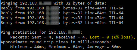

sounds like you may have a network issue. what do you get when you ping your doorbell?
on your command prompt, enter the following:
you should see something like this. pay attention to the packet loss. keep pinging the doorbell to get an idea if your doorbell is struggling to stay connected to your wireless network.
Code: Select all
ping <ad110's ip address>
