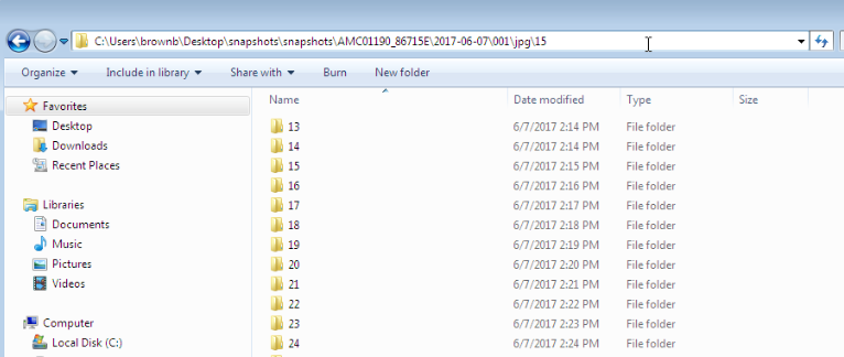

Does anyone know how to configure FTP snapshots to save to only one folder and not create a new folder every minute? During testing the snapshots would upload to the FTP server but were creating new folders every minute. This will prove to very challenging in trying to pull the image to present on a web page.
ftp folders.png (89.1 KiB) Viewed 1439 times

I received a message back from Amcrest Tech support stating the following:
Unfortunately, this is not an option at the moment. Our R&D team is working on giving the FTP folder a better & more personalized configuration for next firmware releases but, as I said, the folder structure is the only one available at the moment
Has anyone out there written a script they would like to share that will copy the images from these directories into a single directory on a Windows server?
Thanks!

I am using other brand camera at work, and have Amcrest at home (trialing). Both are recording to FTP.
Other brand camera saves all files into same folder on FTP with time stamped file names. This much much easier to use than having to dig down through a bunch of folders which is highly unproductive.
However there is a script you can use in windows:
For open cmd line:
Code: Select all
FOR /R "C:\Source Folder" %i IN (*.jpg) DO MOVE "%i" "C:\Staging Folder"
for batch file:
Code: Select all
FOR /R "C:\Source Folder" %%i IN (*.jpg) DO MOVE %"%i" "C:\Staging Folder"
The difference between the two being %i and %%i

TBH I find the naming convention useful. I can go straight to a day and hour to search for a snapshot. With the latest firmware folders don't go any 'finer' than the hour.
If it's of interest, I've got the empty folders problem nailed with a batch file, so simple and works like a dream. I only wish that all problems were as easy to solve :D
My NAS folder for snapshots from all three cameras is mapped to Z: and the following on my desktop named delete_folders.bat
Code: Select all
Z:
for /f "delims=" %%d in ('dir /s /b /ad ^| sort /r') do rd "%%d"
