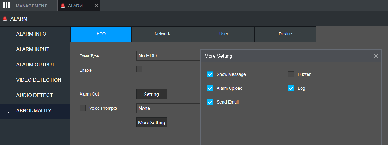

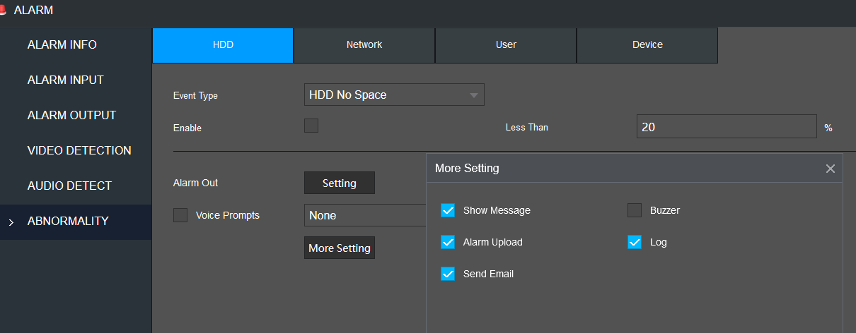

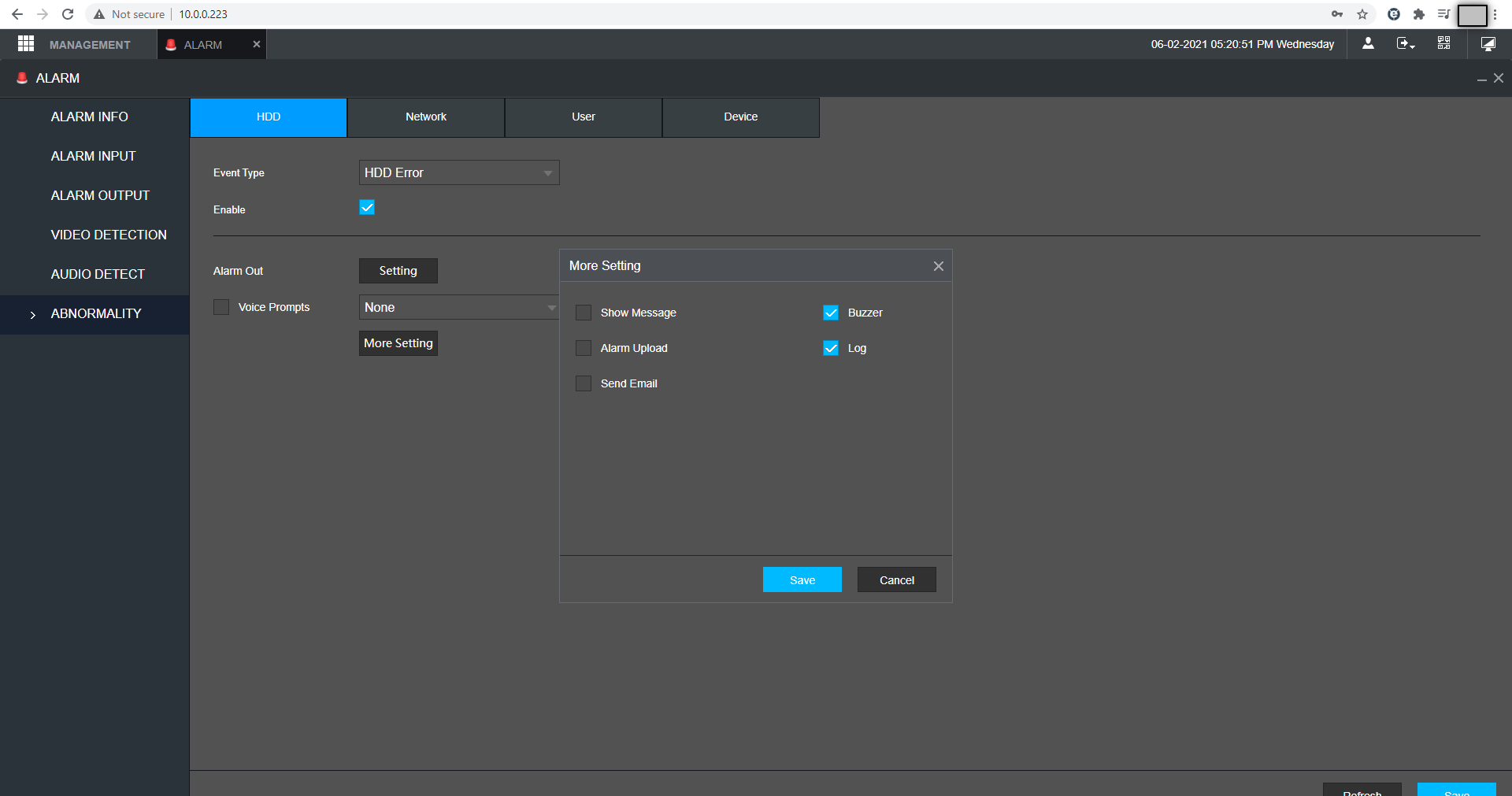

Well I couldn't find it on the NVR so I will have you look at the settings on the WebUI for the NVR...
Personally I would Log in IE if you can that is where I log into the WebUI even on my 4.0 FW and prefer IE WebUI over Chrome/Edge... You can do it from Chrome as well. I just logged in Chrome to double check that option isn't missing from Chrome like other things are Picture below is from Chrome WebUI log in...
On mine anyway it is on the Bottom Left side of the main menu area is Alarm, Then click on Abnormality, then first part is HDD, check to see what of the 3 options has the Buzzer setup on?
No HDD
HDD Error
HDD No Space
Check each of the options and then click on the More for each and see if Buzzer is turned on in that area?
I just did a Factory Reset on my NVR and looked at mine and all of them are setup Enable with Log and Buzzer Checked... So I changed No Space to reflect 20% and added that to mine so now all 3 of them are all setup to Buzz and log

Yeah. buzzer is not selected in all HDD options. But here's two I saved a ss of.
