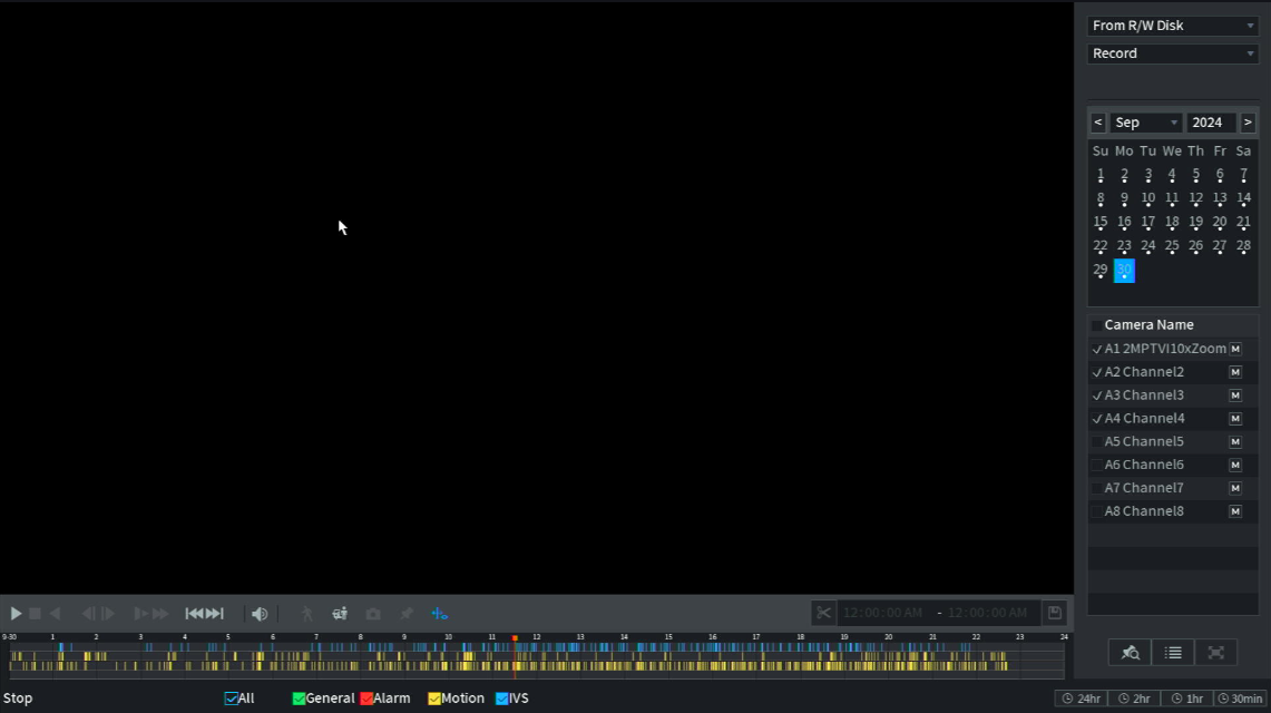

If you open your recorders GUI and click on Playback/Search what ever one your system has. Does it show there was events recorded like this picture below?

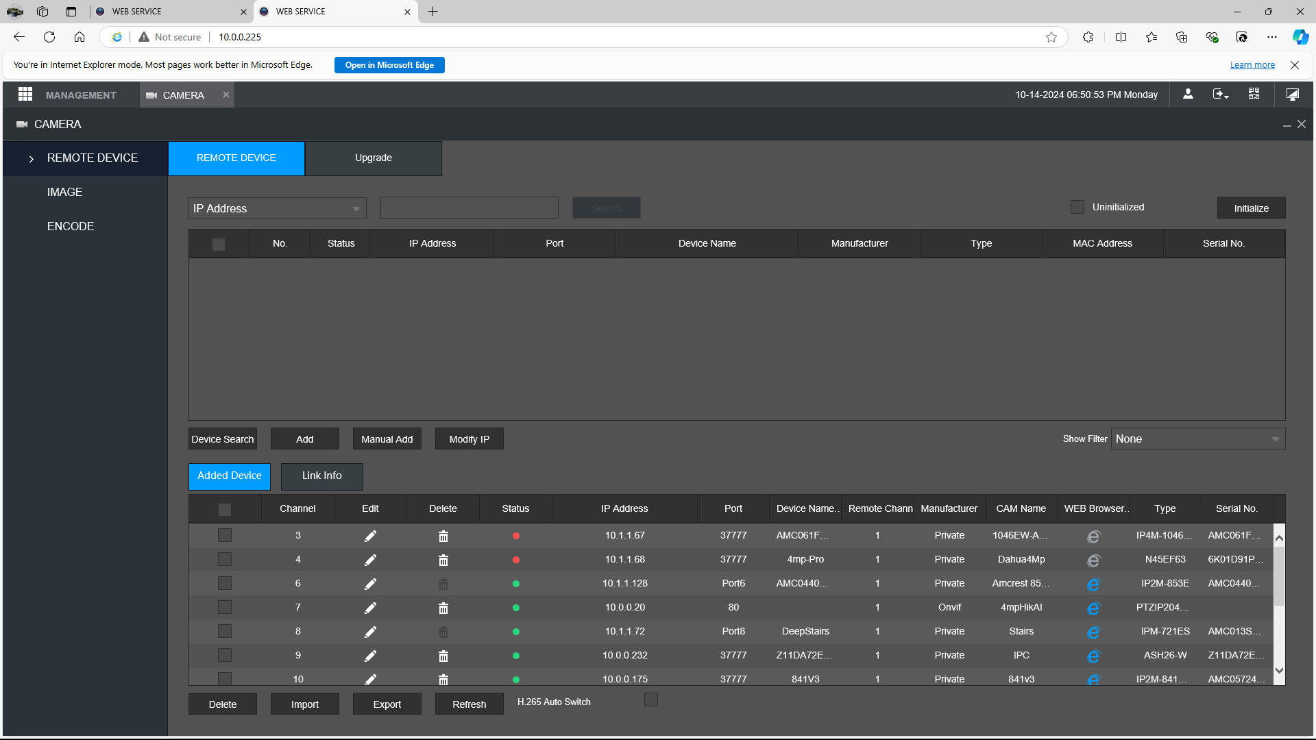

If you have a Red Dot for cameras being offline.. Like the top 2 in this picture.. Then you will want to make sure that the Password is correct for the devices.. If they are not online they are not recording on the recorder..
If you are talking about the Screen being offline after a reboot then the devices is setup not to show cameras without being logged in..
My 2 cameras with the red dot I unplugged them from the recorder but same would happen if you didn't have the right password as well..

Yeah, my solution is, if a camera is offline reset the password. Most of the time that works on ASP. Not this time on the 4108. Is there any setting on individual cameras that could prevent the 4108 from recording? I wonder if my 4108 has some failure and needs to be replaced?

PS: Yes, my screen looks like the one you posted, except all seven cameras have red dots.
