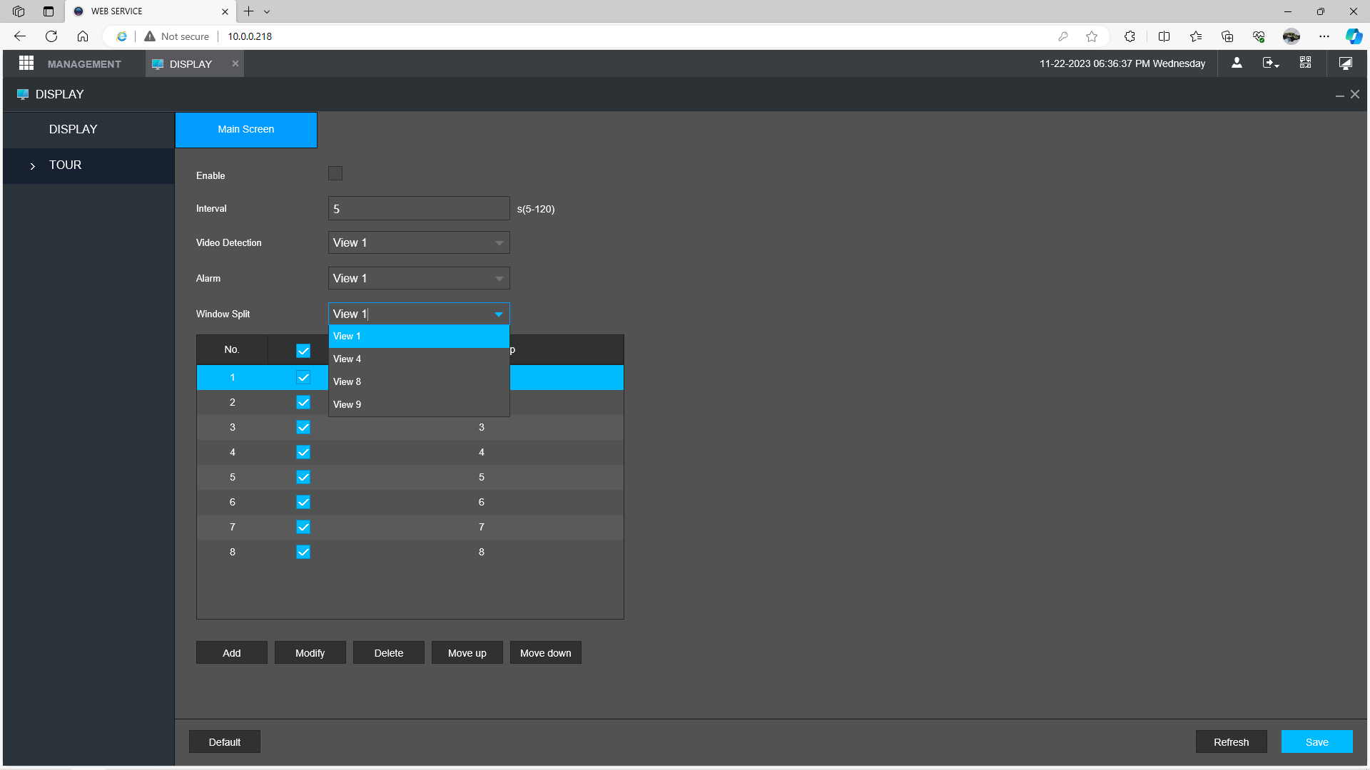

This is from my 4108E-HS NVR. All others are like it that I own just this was one I was already logged into se was best to just make a snapshot from this one..
So yours should also look the same and function within the same type as well..

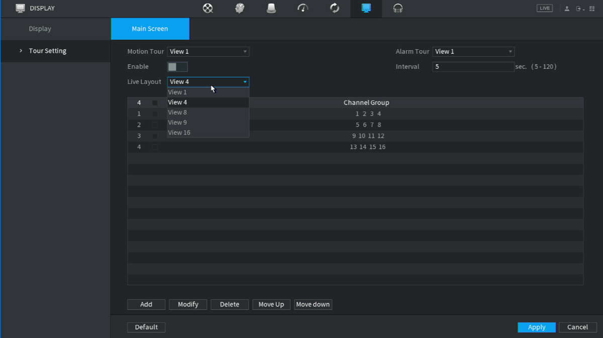

Anyway here is a picture of one of my 16ch NVR's that might give more info. IF you look at the picture you will see that if you only want 1 ch to cycle in tour then you will need to pick the 4, 8, 9 and 16ch tours and remove the tours you don't want and leave only the 1ch setup active with the channels you have installed.
