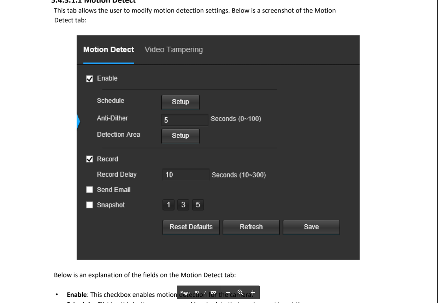

I don't know if that is the case or not. I looked at the manual and it talks about Motion Alerts and saving I took a snapshot of the manual and here is the area that needs to have 1 3 or 5 picked and the box clicked for snapshot also you need to under the Record type make sure that not just Record Schedule is picked but that Snapshot is also enabled..

I have tried checking snapshot and selecting 1,2 or 3 in my 1026E camera. Still no snapshot. Factory support has confirmed that the 1026 model camera can not do snapshot.

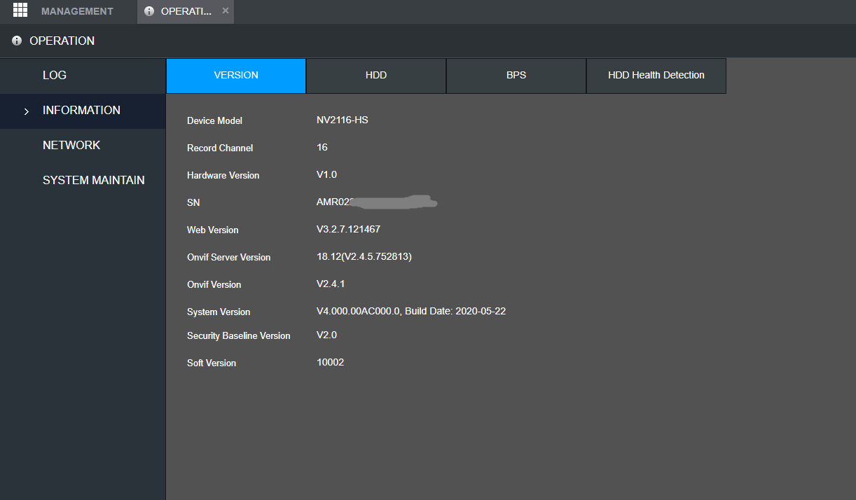

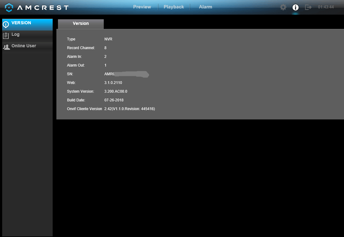

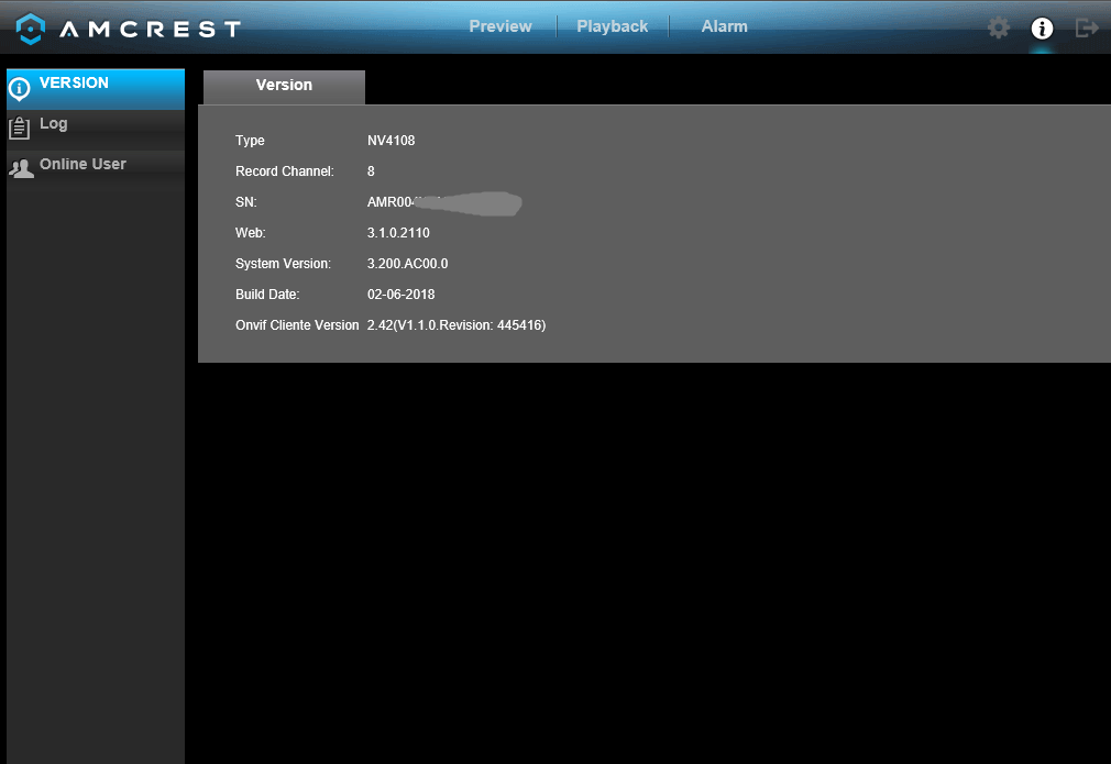

For my NVR's they are H and E without -HS and both were last updated in 2018 one is the one that is still on FW page for last update and the other is for a FW that isn't listed anymore do to issues some had and was not called a Stable Update so it is for POE now also an older online but I have a newer one to make an issue that I was having with the older one does work with the newer FW however again because of some issues outside of what my issue was it was pulled. I could go back to the older but find it has a Flaw I don't like that is besides this post and won't go more into it...
So here are images for my NVR FW info.. These are Black with Buttons.. My 2116-HS is Black top Silver strip on bottom and has no buttons Says Amcrest on Left and has HDD, NEtwork and power with 1 USB on bottom left..
Now I will admit that they are a PITA to get Images but once you have them setup for images it will output an image. Sadly it is a Pain and if it is said they don't offer it that might be because after some more testing while writing this and little before writing this out of 10 alerts 9 had images and crazy thing is one of them had more images then the others because I caused more motion with my settings 0 Anti Dither I guess is why it might have sent more images with longer motion event.. POE 8ch is first image then my 8ch 4018h and the last one is my 2116-HS in images below..
