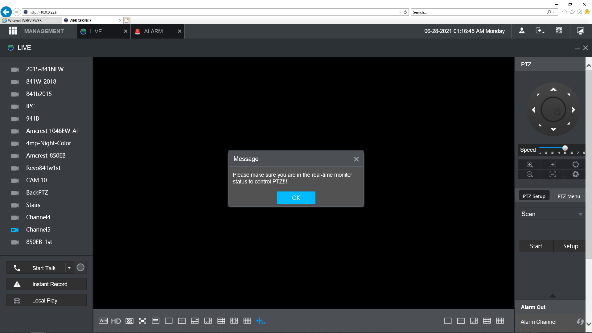

There is something I feel anyone reading this and needing or wanting to do this. While I can't say how it will work on others what I know with mine while working on the 4216E-AI NVR while connected to my PTZ cameras that are connected to my Amcrest 7108-AI DVR on WebUI I get less then 10min of PTZ ability before I have to log out and log back in and to be fair I think it might be even as low as 5 min of PTZ time.. This is while I am connected to my 4216E WebUI.. So if you use the WebUI a lot like I do keep that in mind while working with an Analog DVR over the NVR's WebUI.. At first I thought I had to reboot the machine then thought lets just try and relog and sure enough I was able to use my PTZ controls again...
So to be clear, I have Amcrest 8ch 4k DVR that I use to control my Older Analog Samsung PTZ cameras, I have some channels on my 4216 that are connected though my 7108 DVR, When I log into the 4216E WebUI to access my cameras and say I bring up my 3370-THN, I can access the PTZ, gain access to my OSD for the camera as expected. However lets say I am making a change with-in the OSD for Motion Tracking that I have to setup on a Preset, if I make this change and it can take a little while sometimes lol, if I go say into the Recording area of the NVR and then I try to go back and access the PTZ controls I will no longer have control, I can change to another channel that has my Samsung 2120 or my 2371TH and all access to PTZ controls will be lost.. Now I have not tried to access my 850 that is connected VIA the 4216 so I will need to go and see if it is System wide or if it is only a Communication link between the DVR anD NVR that cause the outage.. I am thinking that it is only a Timmer programmed into the FW that makes it stop working. Like the way the NEW 4.0 FW recorders will make us relog after WebUI connection time out. I am guessing that when they made the PTZ timer setting within the FW it is for the TIME and is different then the time for the NVR going off line..

Re: 4216E-AI Accessing other Amcrest Recorders
So I didn't time it but that is an issue with the NVR as a WHOLE and isn't related to the communication between the 2 Recorders seeing when the system no longer works for my Analog cameras I tried to access my 850 that is connected Direct to the NVR not a Recorder to Recorder connection and it was also throwing that error...
First Picture is Recorder to Recorder and second picture is the 850. The 850 in CH16 is the one that is connected to my 4108E.. So I will start a Ticket for that as it shouldn't be codded this way that it will stop access to PTZ cameras after a set time. It might be 15 min I wasn't smart enough to check the start time lol
