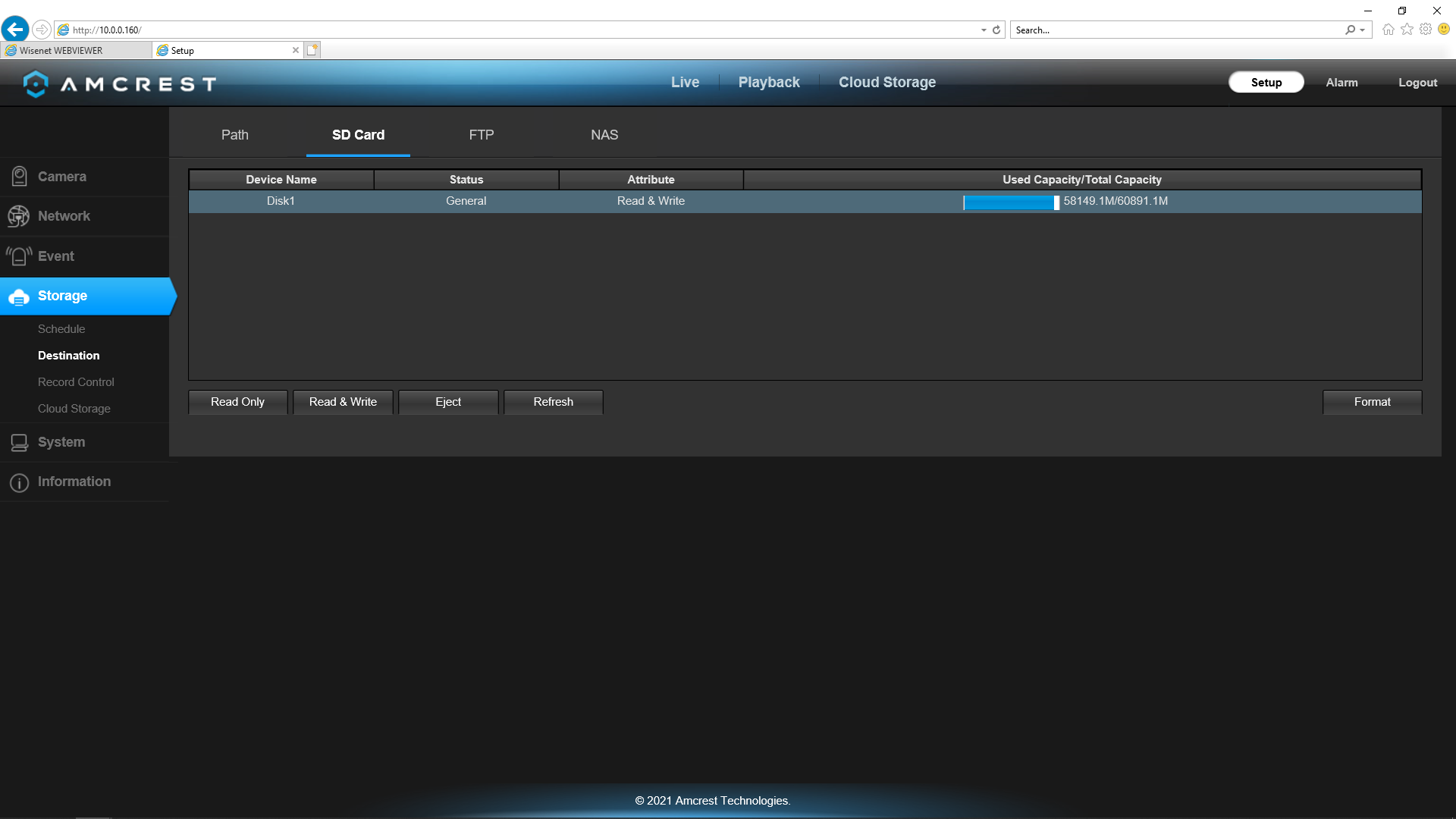

Anyway to remove it one can Remove power if that was an Option or if you want you could log into the camera (If it has the option) via WebUI on the IP of the camera, Click Setup, Then Storage, Then Destination, Then Click SD Card. Then in there under the card info there should be a button that says Eject. Once you do that it is safe to remove the card and will remain offline until the camera reboots. So say you were going to remove it tomorrow at 250pm, and your camera was set to reboot at 3pm if you were not there before the camera reboots the card will come back online after camera is back online.. See Picture Below for what and where

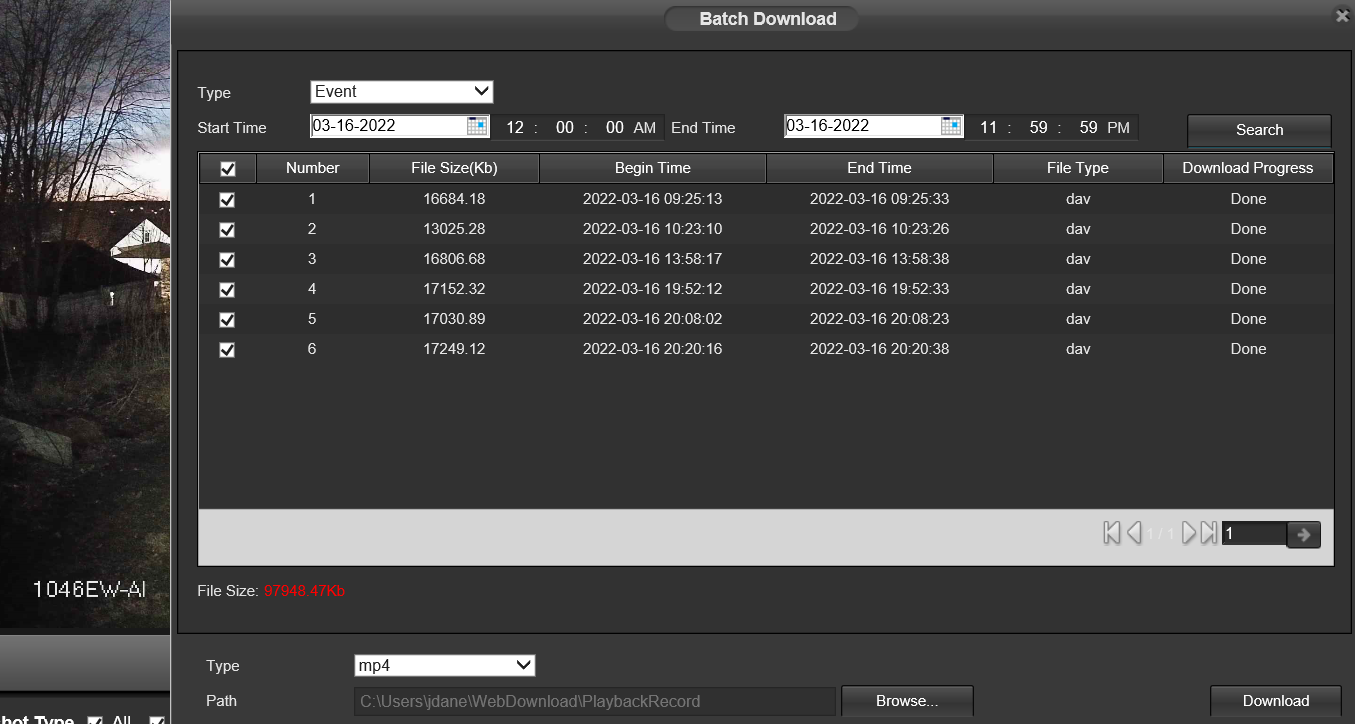

Also thought I would show what it would look like from doing a DL from the camera in truth that is the fastest way. You can do Images if your setup to record them or videos as a batch.
