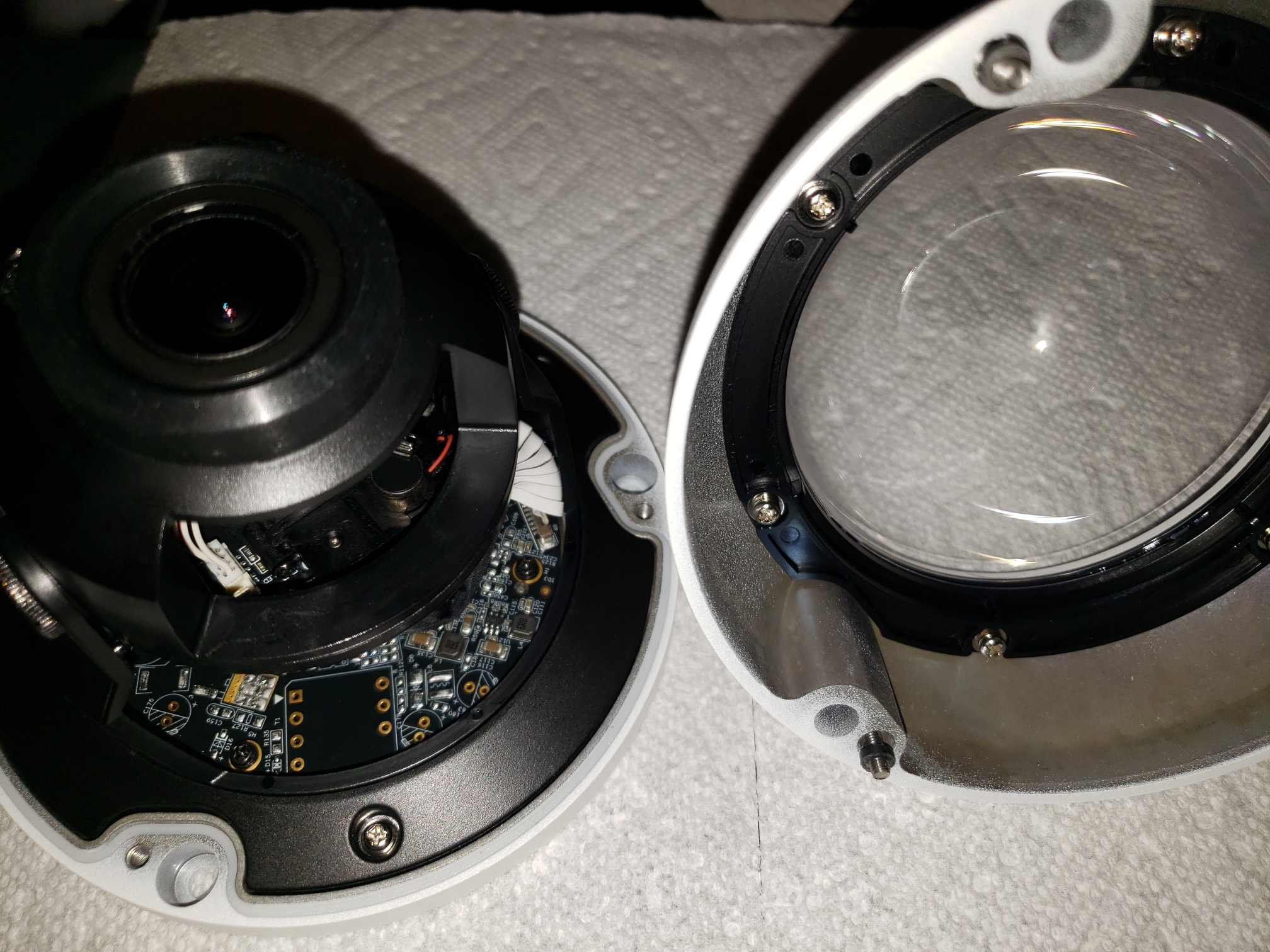

While this isn't your camera most of them are built the same.. In this picture notice the screws under the lid remove them and take out the glass to paint it well.. Plus in this camera you can see that the White was powder coated onto the system... Then on the bottom you will want to take out the gasket seal before you paint it.. Just don't make it to thick and to be honest I would do like I did my other camera and tape it off the seal is tight fight before paint and just be careful removing the gaskets because it isn't like we can buy replacement parts for these things... Trust me I have tried lol

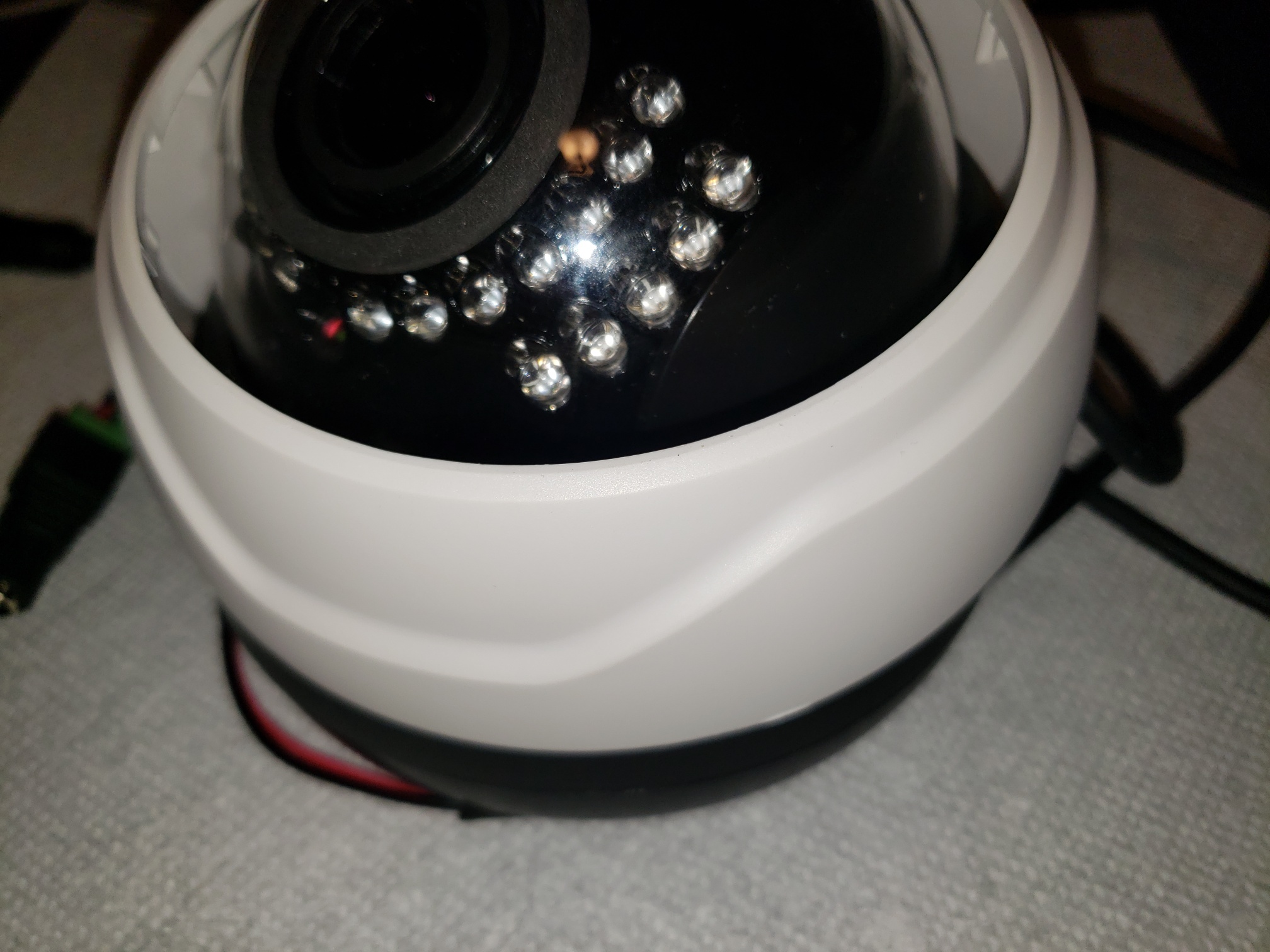

There is a different camera I have that is indoor that comes with a White plain shell with the black logo shell sadly it don't give the white bottom so you have a Black bottom with White shell and black guts it just don't look right so I keep it black... Only set the White part over top to cover up Logo As I dislike the company but have tech from 2010 to 2016 of theirs wasn't until 2018 that I didn't like them anymore lol
