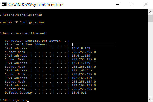

Press the Windows Key next to the left Alt and press R then type in cmd then press enter then type ipconfig
The result should look something like this However yours might or should only Show one IP address and maybe a v6 ip as well... all the others on mine are added because I use a complex network system with cameras in different ranges... Then I need info from your ARP as well or data form the IP Config tool...
However Arp would be in the same window after your typed ipconfig...
type arp -g then press enter
So after the Arp we are looking for what your IP is and what IP your camera and Switch comes up as... You might need a Managed Switch for what your trying to do but we will see what happens when I learn some more info on your system
