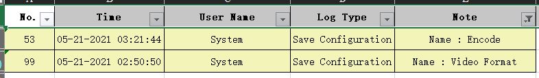

I have an entry in the log for the camera in question:
If I understood you right, this change was made by the system, not me, right?
So you lost me at the last bit regarding the IP of the logged in admin - how do I determine that?Revo2Maxx wrote: ↑Sat May 22, 2021 3:14 pm
Now the issue is that when you have Blue Iris also logged in as admin it can be harder to track things down because most times people are using the same computer they are logged in as, as the Blue Iris computer... However if like me and you have Multi computer network with a system set aside for blue iris or some other software driven system then you will be able to tell what admin was doing the changes with the IP of the logged in admin..

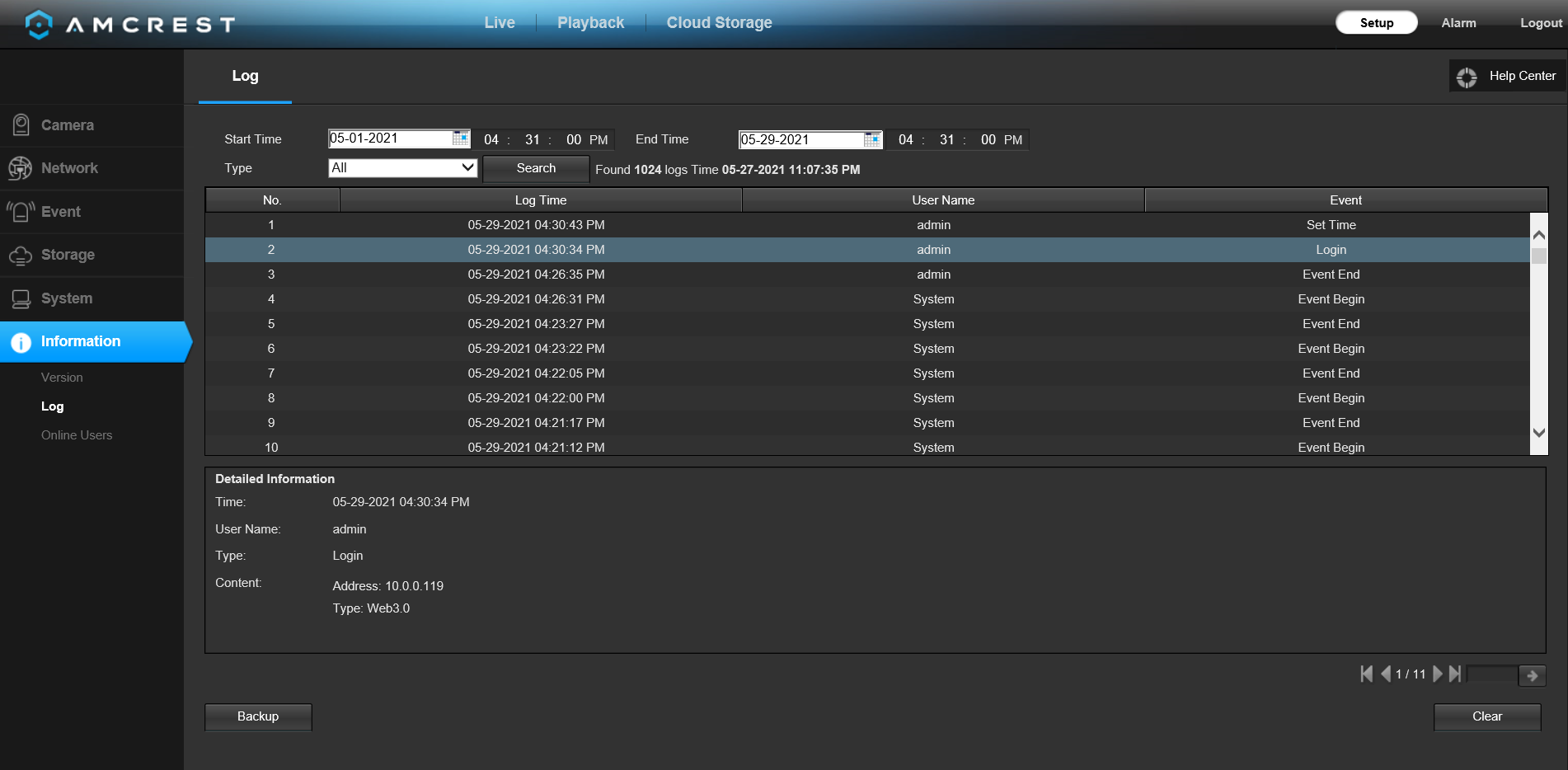

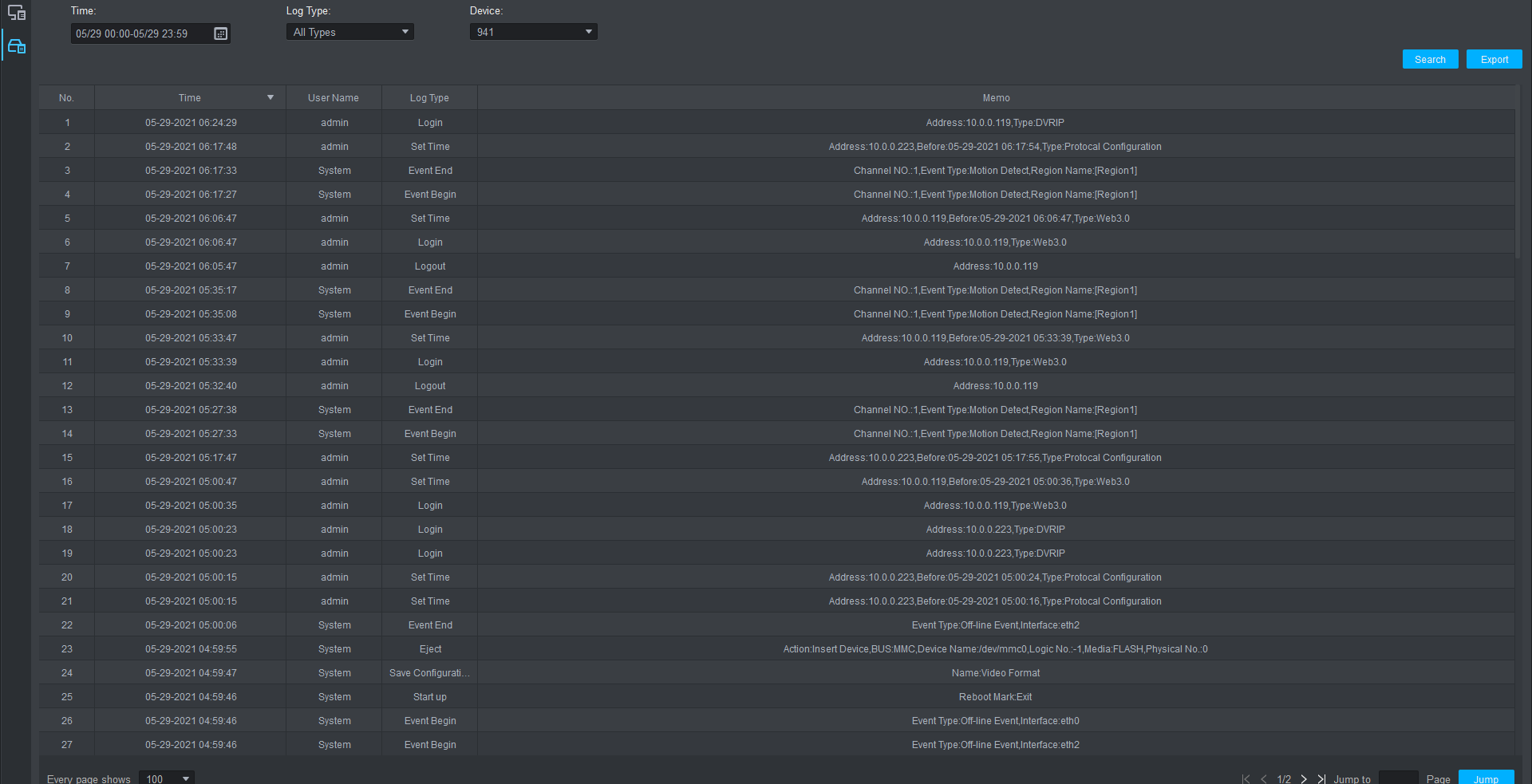

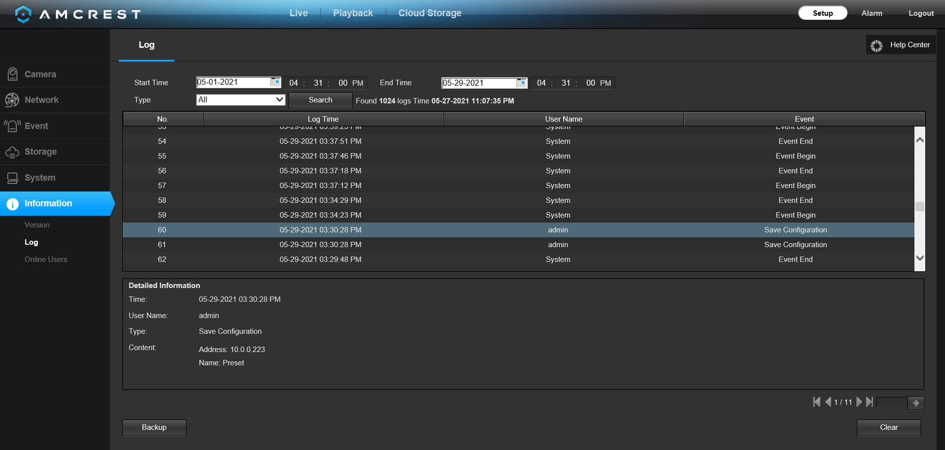

Ok so here is 2 pictures of my Log, While one shows admin with my IP that is from me logging into the camera at this time, the second picture is from when I using my NVR was changing the Preset on the camera and because it was done by the admin while I was online with the NVR it shows up as the admin of the NVR's IP address..
My ip 10.0.0.119, The NVR's address, 10.0.0.223 and the cameras IP address 10.0.0.177..
Then about the system yet that says the system saved the Encoding aka Video Format. . However these have to be done because of current issue either some type of Hardware or software being used... It might be that your not trying to make this adjustment however using cross platforms it might be that the system is being changed by the Win XP machine to be able to access the system.. It might be any number of things... The best way to look at this is not from the log of BI but the WebUI of the camera it self... THen when you see the item you want to look at you can expand it to look like what you see in my pictures and it will say what and where it was made from not just that it was made... So it won't always mention what the IP is however as I have seen on my cameras anyway if I log in camera from my PC and do something that would make the motion alarm go on then admin would show up when it went off so it might say system on but admin off because moved camera, or something outside the system However if it was within the time I was on my PC there would also be a Logout after that that would reflect my PC ip.. Same with NVR when it logs in or out it will show the IP of the NVR..
SO lets say your XP was the issue it should show in the cameras LOG off the cameras WebUI.. Log in to the cameras IP, then click setup in top center right, then click on Information at the left bottom of the screen the click on Log..

I'm not using BI to review any logs. So here's what's maddeningly frustrating... accessing logs from the web UI (typing the local LAN address in the browser) is not consistent with events reported by Amcrest Surveillance Pro.
In my previous post, that screen cap of the log was exported to an XLS file from within ASP - I filtered it in Excel and took a screen cap. When I log into the camera with a browser (the camera's web UI), the event doesn't appear. That is to say, there is no event at 03:21:44 in the log delivered by the web UI - yet it appears in the log generated by ASP.
As a side note, the web UI is too inconsistent from browser to browser and even camera to camera (I also have an Amcrest IP2M-841B-v3) - so my best practices to access either camera is to use ASP.
In summary, since the event doesn't appear via web UI, I can't determine the IP logged in when the event occurred.

Within your WebUI it would show up because it would be an event within the Camera and not within ASP or BI... Looking at the EVENT LOGS off ASP as I can't remember and assume is is still the same as the SmartPSS within reason.. However since I started having Time issues and other things while using ASP I no longer use it.. However if you look in the logs area, there should be a tab at top that will let you search the camera logs as well.. As you can see from the picture here this shows the log that is being sent off the 941 to the SMARTPSS software and ASP should also have the same feature...
Looking in your logs for the CAMERA if there is any area that mentions Encoding that don't have System or Admin next to the user area that is being done off the Cloud as it used to be that way I don't know because I have not used cloud service for over 3 years now because of that issue or 2 years either way it has been long ago..
