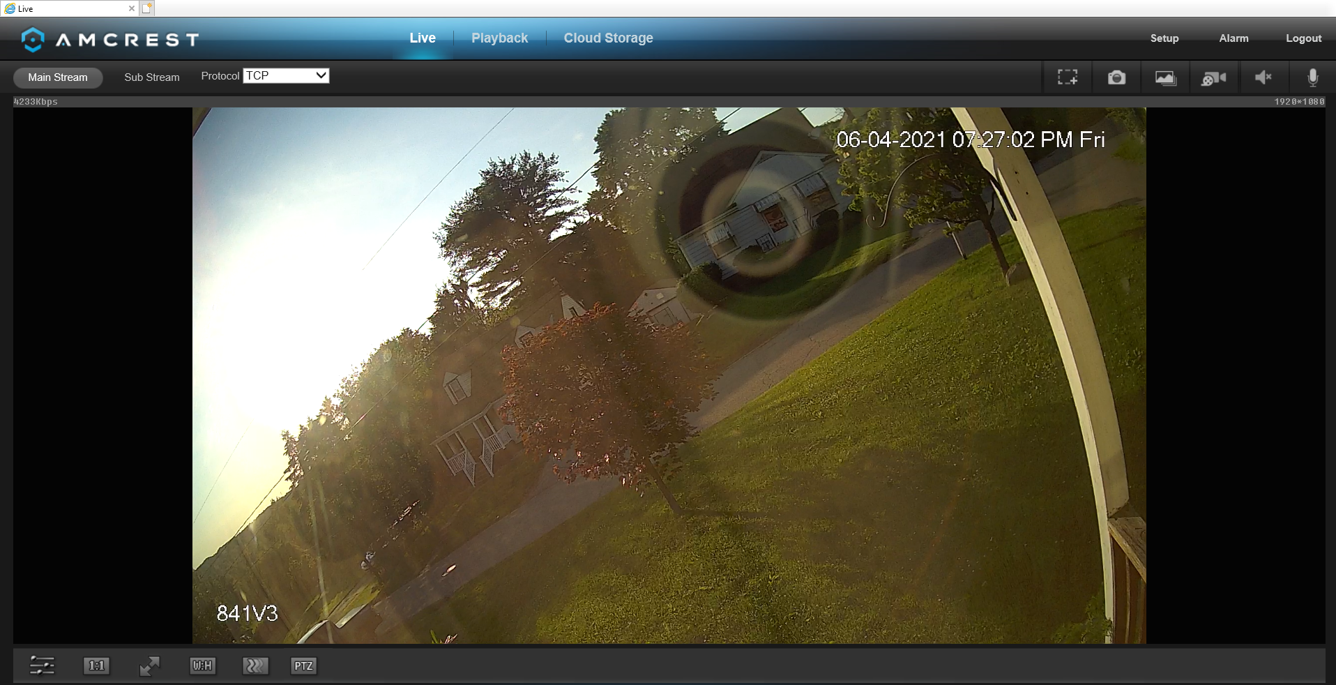

I bought this camera hoping that I could record when people walk by my house but it won't do that. It will record every car that passes by but will not record a person walking. I have changed sensitivity settings and nothing works. If I set it above 95 it will record the tree branches blowing in the wind constantly. Anything under that and it will not record a person. Is it possible or should I just return it and move on?

I had to turn sensitivity up to 100 for it to notice people. Now it activates when it rains. The tracking simply does not work.

I am not sure where or what your camera is setup for, I think from the sounds of it that you should do a Hard Reset of the camera and set it back up...
So I setup my V3 like I said I would in the area of another V2 camera from 2018. Both cameras I have them setup 45 feet to the Road and have the V3 setup from factory only changing the FPS and bit rate for main or sub stream and then changing the Motion Detection area for the Road.. This is going though Double pane window and it is detecting everything as expected..

So In the last 4 hours I went and made some changes right after I posted my last post, Formatted my MSD again and in just last 4 hours I have 46 pages of jpg and over 145 motion records.. Looking over the recorders and looking over some other cameras to find the people so I didn't have to sift though each of the detections there is 31 motions with people the rest are cars.. All 31 of the detections took without an issue.. I even have my camera in a strange position in this last 4 hours to see if that would mean anything and all was good.
Do you have a Picture that you could share of what type of area your dealing with?
Only thing I can think of outside of all other stated.. If there are a load of things within the Motion detection area that are moving already and the area for humans are very small it might be that the camera can't get the info processed fast enough to cause an alert? Seeing the Trees are with leaves right now I did see there are some detections with looking at the JPG files on mine were a car from it speed would be behind the tree.. Looking at the video aspect of things cars going from right to left seem to have better detection then cars going from left to right.. With people it was different because they are slow enough and the view is wide enough I get the whole detection even between the grids seeing I have the Trees out of the grids to keep alarms from false alerts..
