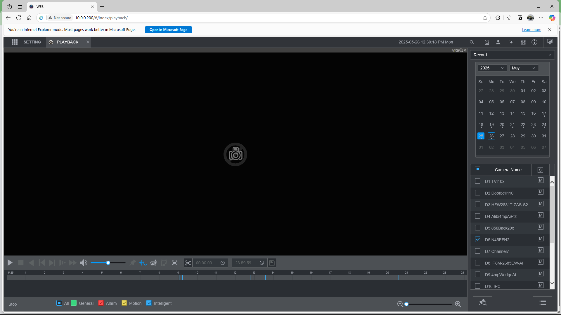

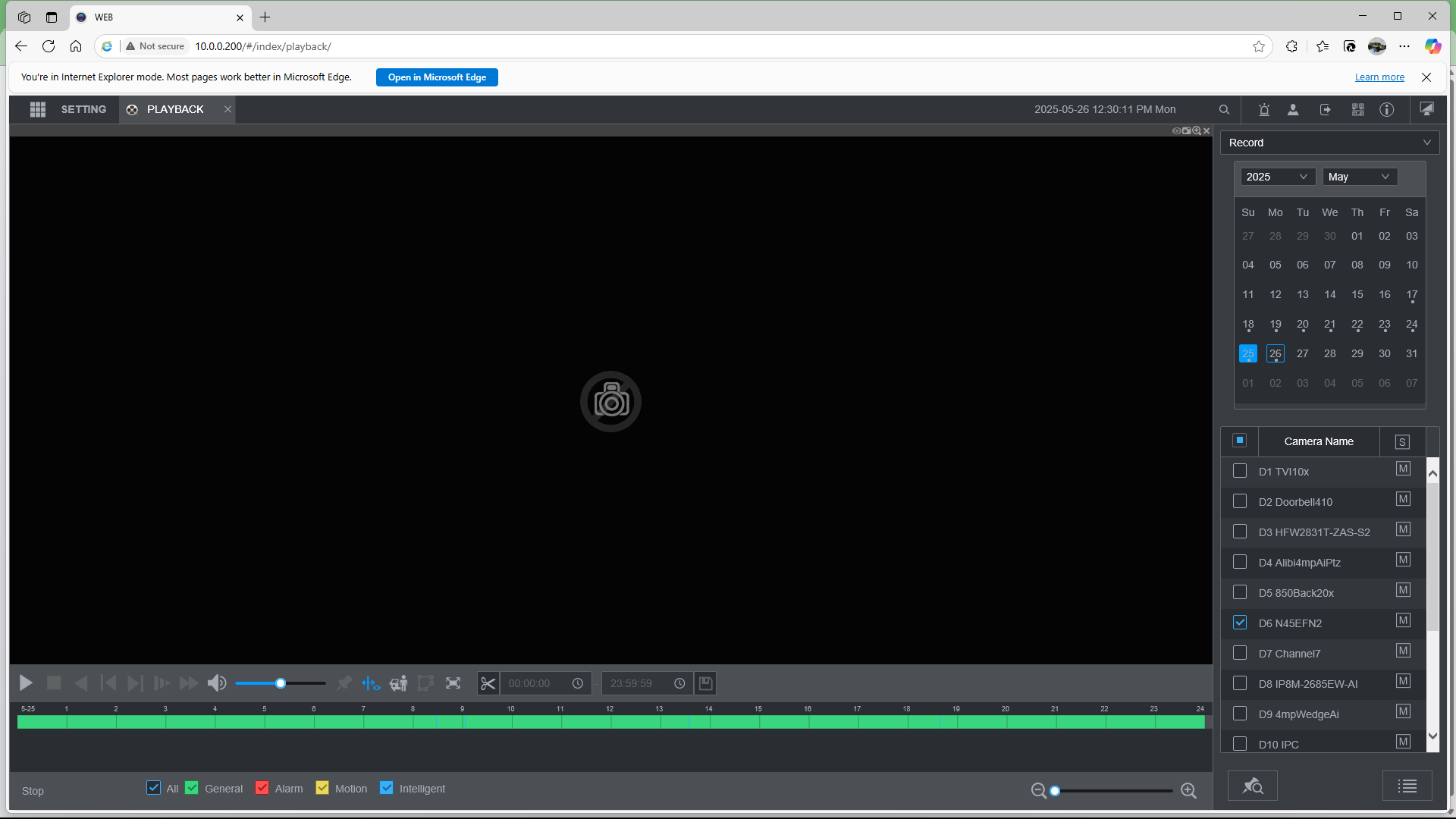

So I will show you what I am talking about.. In the pictures below you can see that I am recording full time on my NVR. I have my camera setup for IVS tripwires now in the picture you will see a tripwire in the street but it is only setup for Humans. So that is why IVS is low that is the first image showing the blue lines.. That is in my Driveway or the few that passed walking in the street..

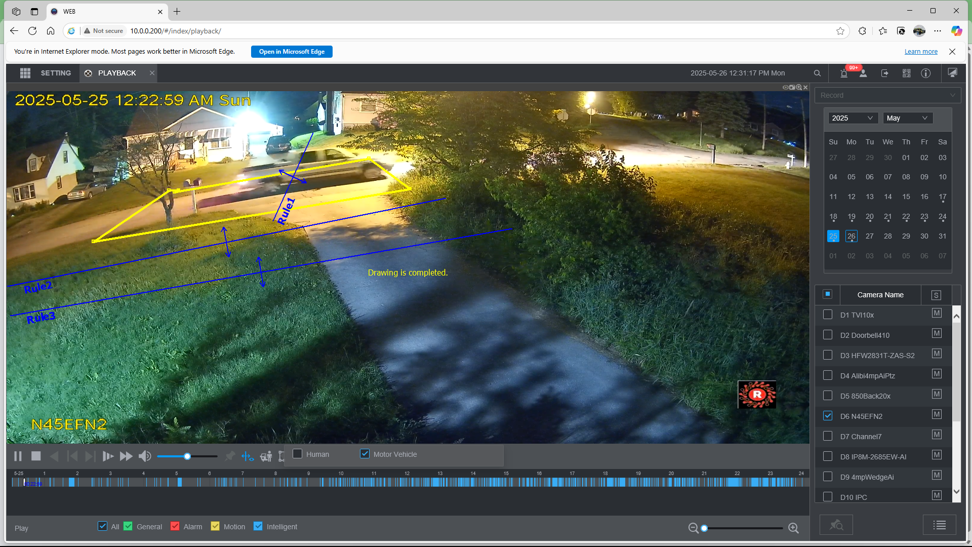

Last image is my doing a motion detection Meta search. Now this is what would have happened if I had motion enabled to record. besides I would have had all that as yellow events and loads of alerts.. Anyway with this I know that each of them events for me are real Vehicle events that went though my area of interest.. If I had placed it at the corner there would have been a few more that came down street and turned up the hill and didn't pass my drawn in box..
This is a feature off my NVR but wanted to give you an idea of all the alerts that would have been sent if I was to have only setup for motion and first picture with blue lines that was like less then 20 is all I got for alerts because they were what I wanted to be alerted about..
