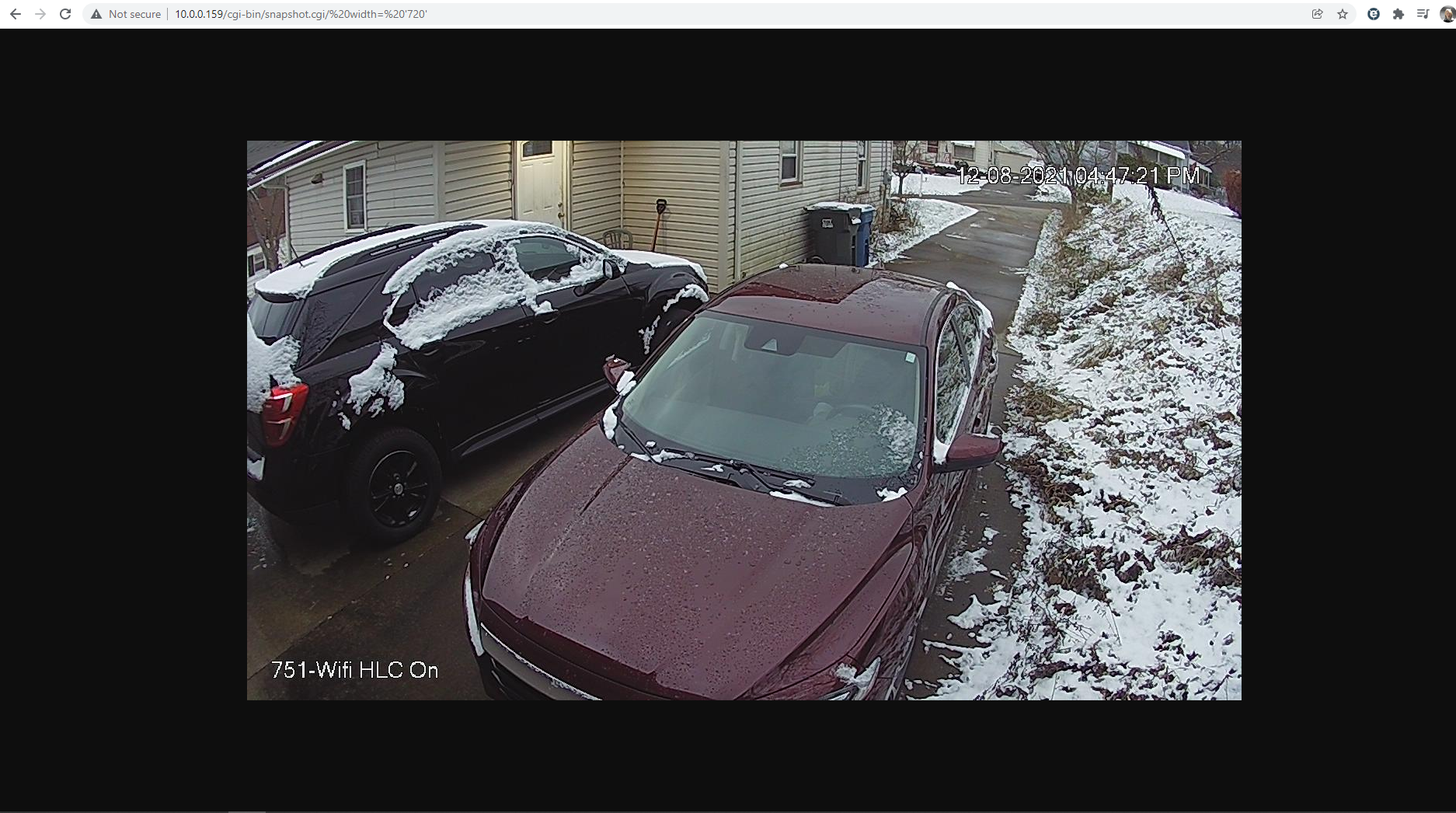

Posts: 5966
Re: Authentication Examples?
@jantman It all depends on the camera. I have a Old FW camera that it will work on so it really is FW related to what can and can't work. Maybe they are working in a older FW camera I just used it on my 751 over Wifi and it returned a picture

@Revo2Maxx Oooohhh, you're right, sorry, I forgot that this wasn't mentioned explicitly in the thread:
HTTP Basic authentication (which works using the
Code: Select all
username:password@host
format in URLs, and is generally much simpler to work with) is considered insecure. A few years ago Amcrest updated the firmware to use Digest authentication instead, and thereby solve a security risk. Unfortunately, Digest authentication is much more difficult to work with... you can't just throw a username/password in a URL and have it work, and you can't just easily proxy or re-broadcast a stream.
If you have an older camera, or a camera still on the older firmware, you can just use Basic and have none of these issues.
I can't find the exact date/firmware version where the change was made, and it looks like the firmware download site no longer has a change log for... anything...

Posts: 5966
Yes funny thing is I have some other older cameras that it won't work on as well. Like my 850EB's and my 956EB, 846EB. While they do have older FW I am going to guess it was released after the issues and got the updated info that was needed to plug the hole. I know my 721ES, and my 751 both will work with the command. The 721ES I had to put on my normal network to test the command seeing it is normally behind my NVR on POE port. Now just gives me a reason to change out my 751. Don't really look at the feed much anyway just one of 4 cameras on my Driveway. The 721 is on its post because it has a Mic and have enough 841's and others that I could change it out but only on my Stairs so don't really matter much if it has higher then 720p output. Not broke don't fix it.. or in this case don't change it..
