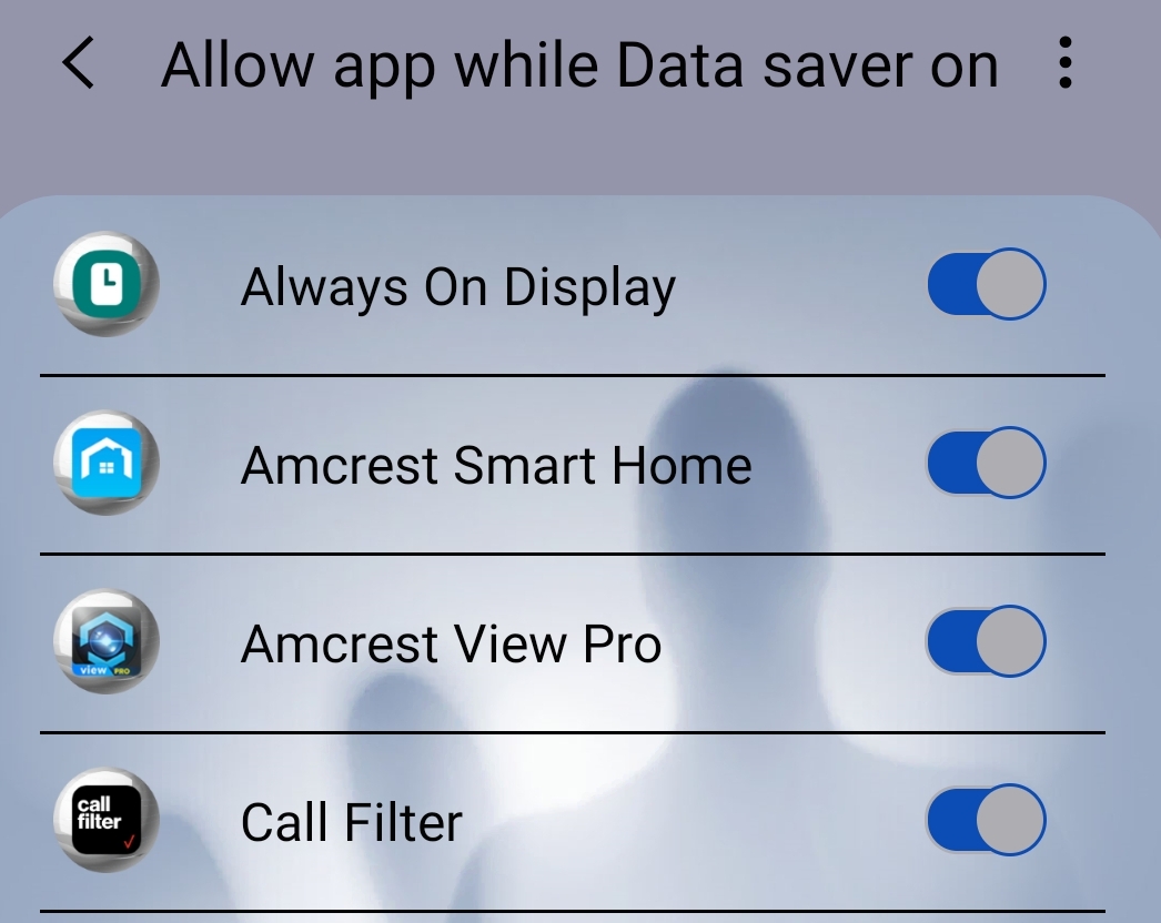

I FOUND THE SOLUTION!!!!!!
On my Samsung S10, I had Data Saver turned on. I turned it off and Live View was able to display my cameras without a Wi-Fi connection......
I always had Data Saver on with my S8.
Re: Amcrest View Pro Remote Viewing with Android V10
Awesome I am glad you found it. I couldn't understand why it wasn't working... I have had my Data Saver turned off... I just thought I would mention that looking at my phone I turned it on and as it was I to couldn't get the Video to show.. However there is an area that you can click on where the toggle is and then you can click on Amcrest View Pro app and it will work with the Data Saver on if you wish to have the feature active...
Yes, I saw that. I tried allowing Amcrest to run with Data Saver turned on but still would not allow me to view. That’s fine, as long as I know I have a simple toggle to turn off if I’m not within a Wi-Fi network...
