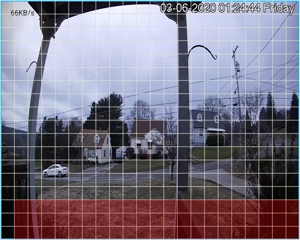

Revo2Maxx wrote: Fri Mar 06, 2020 12:34 pm Hello Bit8Bit welcome to the Forum... Sadly motion was tricky.. I can say that I have mine on the 3 lower sets and I changed my Detection level down to the second dot on the level... Sadly I can't say this is good for everyone because I have mine set on my NVR to record and don't really care if I get alerts on my app unless someone presses the button... I was getting loads of alerts but I have a road that points my front door now I get no lights because I also change the Schedule to remove that time when light would set off the camera because it does SHINE right into my camera when they come off the hill...
So the documentation is pretty bad on this. Is the Red Area where the camera will detect and the rest is excluded? I may have mine backwards.

Sammy wrote: Thu Mar 12, 2020 9:03 am So the documentation is pretty bad on this. Is the Red Area where the camera will detect and the rest is excluded? I may have mine backwards.
yes, selected zones are in red. i suggest don't go overboard with selection area to minimize false detection. only use the smart home app in setting motion detection zones.

Sammy wrote: Thu Mar 12, 2020 9:22 am Is that to say don't use Areas of Interest in BlueIris? I'm pretty sure that is in the software itself and not in the camera.
the software changes the configuration settings of the camera hence your doorbell native motion detection stops working properly. i would suggest you do a hard reset on the doorbell, use smart home app to set motion detection zones, use blue iris only to review and record--don't set motion detection zones with blue iris.
