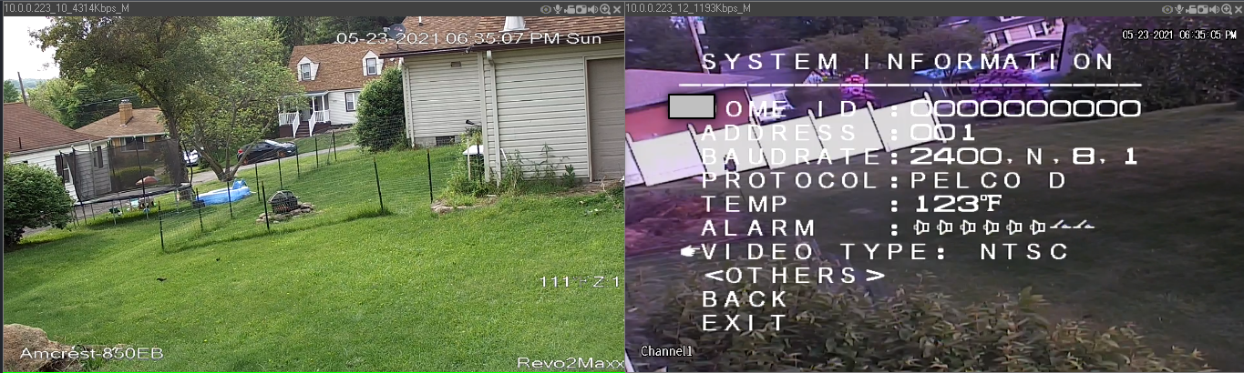

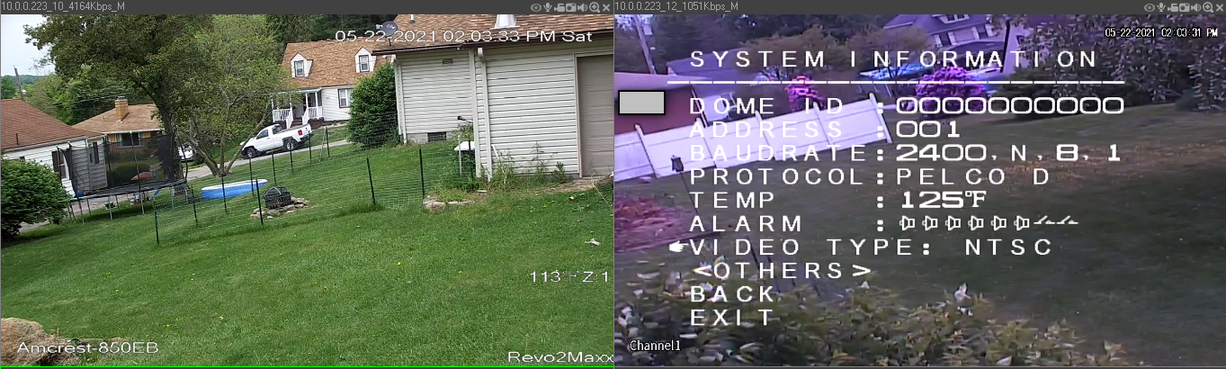

Sadly I can't say that I buy the whole color thing.. Looking at yesterdays numbers between my White G4 IR PTZ camera While it don't normally have a Temp setting I have changed it out with a different set of hardware and now is able to see the Temp from the OSD like some of my Samsung cameras seeing it was from a Samsung housing lol.. Anyway looking at all my cameras yesterday that have Temps none of them got over 131 and while my 850 was at 111 one of my White Dual walled PTZ camera was at 127. Today while writing this the 850 is at 113 and my white one is at 123 and the ones in the shade are still under 95 right now.. So I will show 2 pictures of the ones that are Exposed to Direct Sunlight however today isn't very bright out today and since I first looked my White Samsung camera is now at 125.. 850 on the left and Samsung on the right..
Edit: I take that back I do have some White Amcrest cameras sorry forgot about my 1046EW-AI's are in white..
Re: 850EB and Safe Temperature Ranges
My 858 is using 12V power and is mounted on a 4x6 post. It has almost constant direct sun exposure.
Today the sun is out with an occassional cloud. Cam has been in full direct sun, no cloud, for several hours.
Cam internal temp is 118°. Outside temp is 86° with 49% humidity.
Two days ago, cam temp was 95°. Outside temp was 69° wih 95% humidity. Very light rain around.
Current 858 stats: I think the biggest difference, if any, between black vs. white cameras would be when both have constant full sun, no clouds, and hot outside temp.
Thank you again for taking the time... Looking at today it is a very hot day and oddly not sure why the other day was different then today seeing while it was sunny out it wasn't as hot as it has been for the last few days.. Today being a cooler day then yesterday the camera is 111 at this time looking at my White camera also in same Direct sunlight only difference is that the White camera is on the side of the house that is Beige in color and the 850 is on my Shed almost 200 feet away that is on Brown powder coated flashing on lower side of a black roof so in truth of looking at what is going to be a hotter area in contrast it would be the 850.. I did a few days ago change the white camera from Auto to cool only mode and today while the 850 is now 113 the white camera same side with Direct sun light of the house and below the roof line by 15' that camera is 123 and it is starting to cool off with sun now going behind some clouds..
