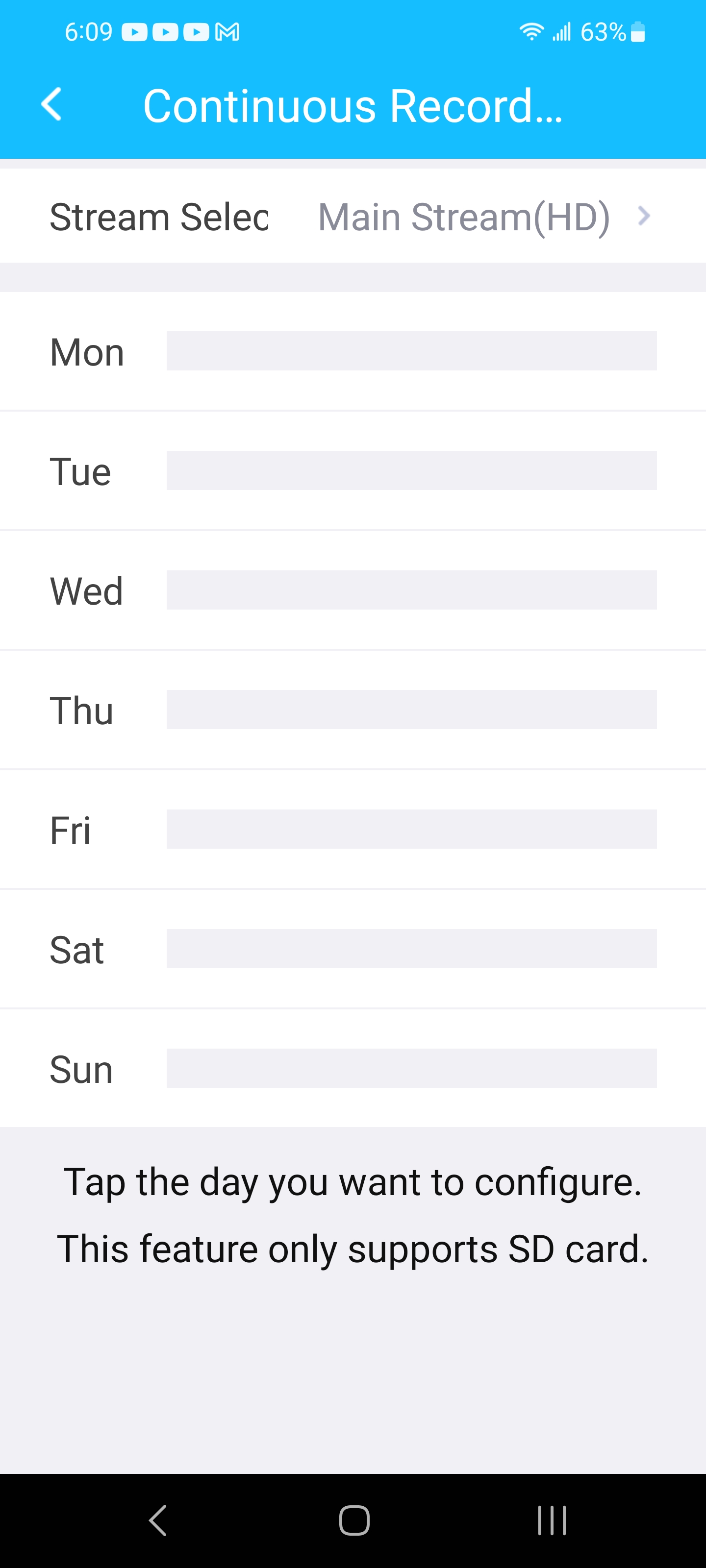

This enables the system to record Full time on device rather than only having ability to record motion or human events for people that have large Micro Sd cards installed. I already record full time on my NVR in Sub channel. That is also an option on AD410 record main or sub.
Re: New Firmware for AD110 and AD410 Available
So I am already recording 24x7 to an NVR and of course have no need to do the same on an SD-Card. I expect that is not the only update to the firmware, so again - it's essential to see the full release notes. Hopefully they will have some detail.

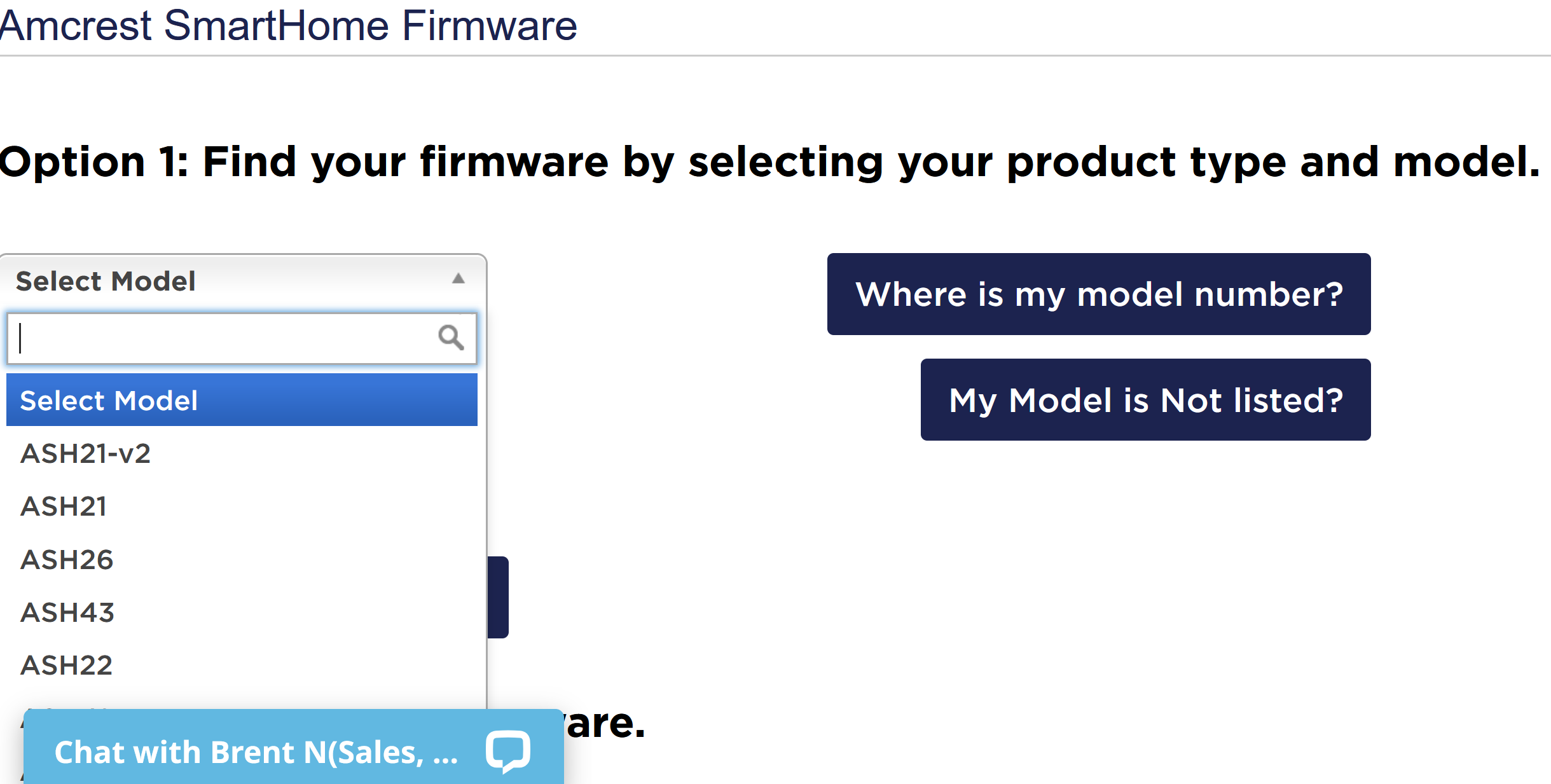

@davidski - I have no idea why the new firmware isn't available yet via the SH app, but it can be downloaded from that link. Unfortunately, it's not obvious.
This ASH link only displays ASH models to pick from, and no doorbells. But if you enter AD410 into the search box it will find it. Then you have to click the Search button to bring up the page where it can be downloaded. Then it has to be installed with configtool. Search Amcrest support pages for instructions.
To make matters worse, the stupid sales chat window keeps popping up over and over after closing it. And even when you finally get it minimized, it obscures the lower items in the menu pick list.
Just a really bad design for a download site. Maybe Eli can let the web designer know.
Good luck installing it and hopefully Amcrest improved the code to work with mesh networks better.
