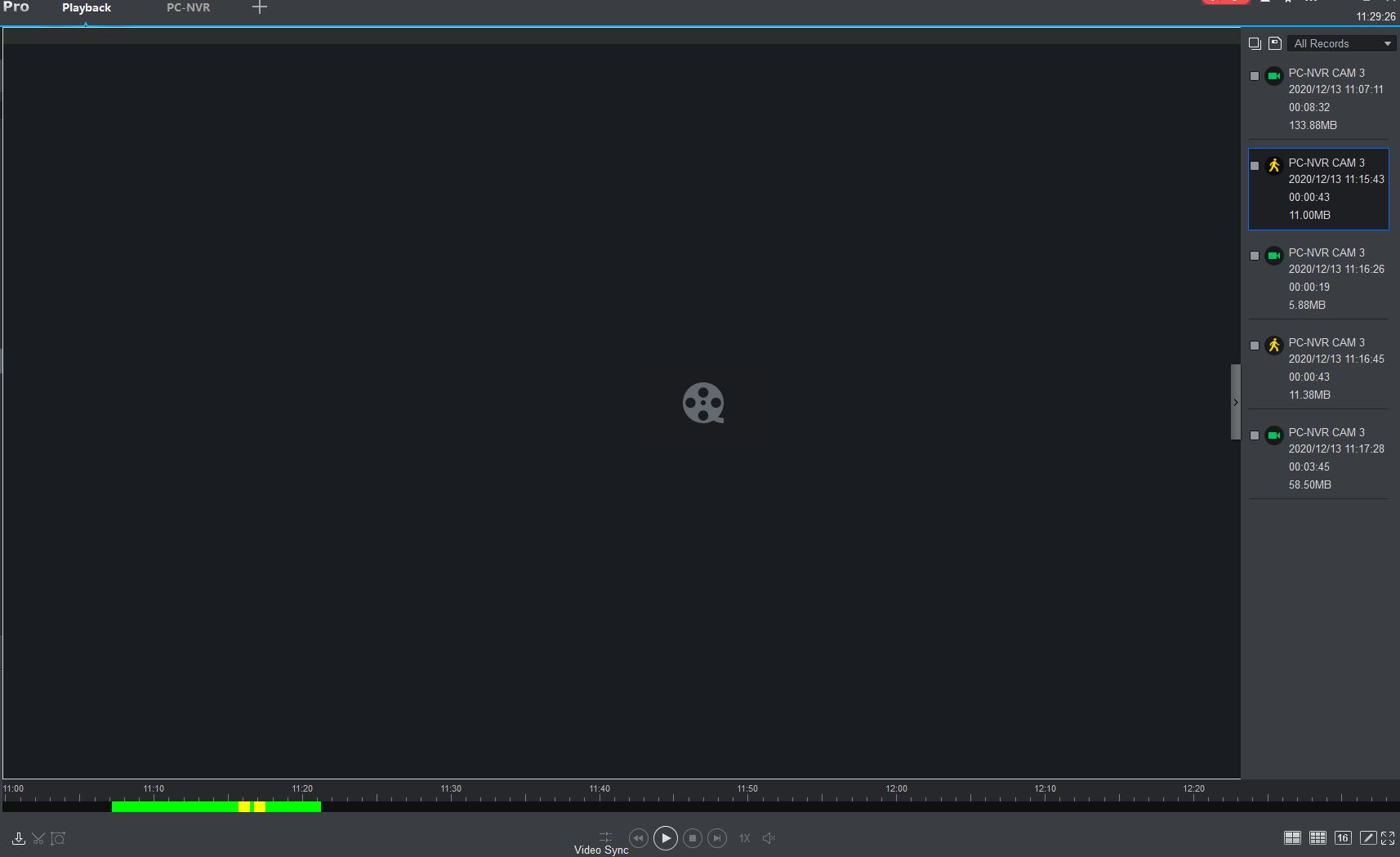

I have used ASP PC-NVR with the Smart Home ASH21 to record 24/7 and motion event video on a PC disk. ASH42 would likely work too. Snapshot below shows the ASP Replay screen. Amcrest View Pro can also replay the PC-NVR recordings by adding the PC-NVR IP address to View Pro. The current ASP is available at https://support.amcrest.com/hc/en-us/ar ... llance-Pro
That ASP, dated 2020-11-30, is about the same as SmartPSS, except ASP supports Amcrest P2P devices.
