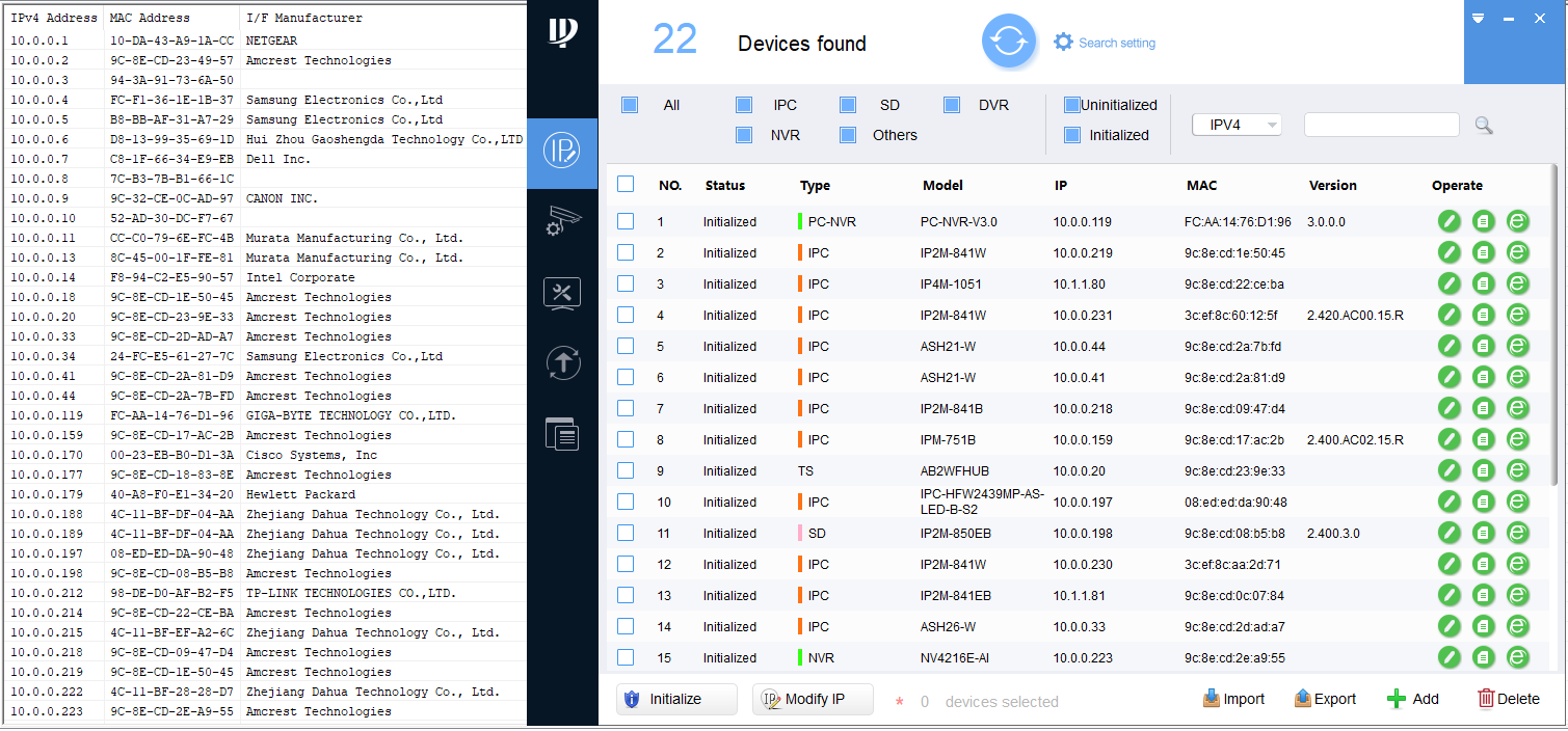

Sorry no one wants to take advice about how to setup the Camera.. So here I will show more then I want to show of my system..
First picture is an ARP on the left of my Mac address and on the RIGHT is IP config please NOTE I OWN ONLY 1 ASH21....
Second Picture I took a Picture of one of my Router Tables, This shows the ASH 21 setup on the router and because I normally only have the IP setup on and running WIFI, the Wired is BLOCKED.... I didn't not change that Only thing I did was remove other things from the Table and cover my Wifi SSID because no one needs that INFO...
Now please LOOK. Setting up the Camera right with the camera being setup with Wifi only will make your camera have 2 IP address if this camera is setup right.. IF you don't setup the camera right and connect the camera to the Cable to make the setup and then add the IP by doing this causes the camera to keep the IP address info of the Wired setup as the WIRELESS setup... SO if your trying to connect this camera to 3rd party software or hardware and want to use WIFI then setup it OVER WIFI to start if you don't it will as everyone is saying loose all port info when it is removed from Wired because in a since you are no longer connected to the Camera in the way it was setup to connect...
I REPEAT I only have 1 ASH21.. There is NO funny business.. This is what my ASH 21 will do if I take a Cable and connect to the camera after the camera was setup VIA WIFI and had been working on WIFI only... After remvoing wired My ash21 will still stay connected with the WIFI as I have it setup.. IT has 2 Mac addresses and 2 ip addresses.... Because inside the camera has 2 ETH connections an ETH0 and ETH1
SO why does mine still work. Because when I am removing the cable from the camera after ALREADY having it setup to RUN ON WIFI it has it's own IP and its own PORTS... Remove the cable no damage to the cameras WIFI PORTS and things keep working...
IS THIS INFO UNDERSTOOD>......

So I forgot to finish my thought... If you look in my ARP list on the left you will find that in the list is an 841, This camera was setup on a WIFI setup first and then I later ran cable to the camera.. This camera is only being found in IP Config Tool with the current running IP over the Wired connection however if you look in the list I had it setup for 2 different IP on a Static Setup.. So even one of my 841's from 2015 that was setup on a WIFI, Then setup for WIRED while connected has kept the 188 and 189 on the same Mac ADDRESS however if I setup this camera on WIRED only it will have a different Mac Address... Now because this is the Wired ADDRESS that is the Mac for the Wired Connection what is missing is the Wireless connection Mac address as you would see if I had it enabled in Wifi with SSID and login.. Right now it is only wired. You can see looking at this Video.. https://youtu.be/30CN5Ct-hC0 this will show that on the 841 that is showing in the ARP list above with same MAC address in the VIDEO you can clearly see in the Wireless setting area that the camera has a different Mac address just not in the ARP because it isn't active however I can connect to the camera over Both IP addresses as I am doing in the Video..
This is the same kind of Mess up that is happening in the ASH21... There are 2 Mac addresses as the list above shows in the IP config list
