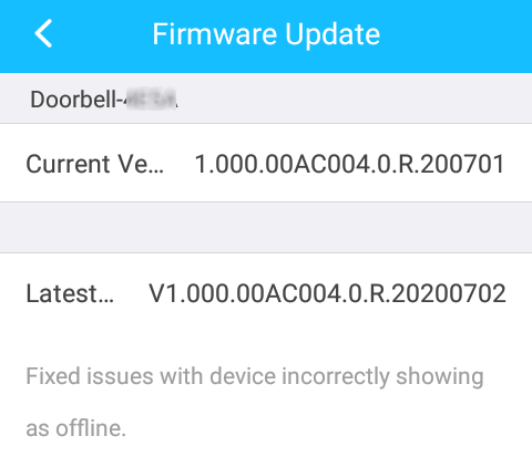

Just updated to this version. The notes for this firmware, as viewed in the Android version of the SmartHome app, stated it was to fix an issue where the doorbell shows as "offline".
Before the upgrade, mine had this problem. The Smarthome app showed the device as offline, but in the Amcrest ViewPro app, it was still showing video. The doorbell and motion detection wasn't working though.
I deleted it from my Smarthome account and re-added it. Still was "offline". I did a hard reset on the unit by holding in the button above the SD card slot for about 15 seconds.
The unit came up, I added it to Smarthome again, and now it's OK. At this point I saw the Firmware upgrade notification and did it.
Only time will tell if this was successful.

Re: AD110 firmware v1.000.00AC004.0.R.20200702
Updated last night and of course didn't know about the night update issue. I think my unit is bricked. Hard reset 'appears' to work but I get no audio from the unit notifying of reset or after it is booted to say that the wifi is enabled to enroll the device. Am I hosed here? Anything else I can try?
