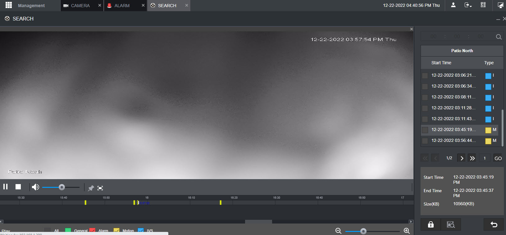

When I do playback, get data for General recording (Green), Motion (Yellow) and Blue (IVR), but for the life of me I cannot get the Alarm (Red) bars to show up.

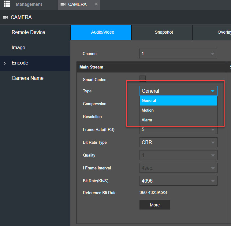

Under Camera/Encode, I would like to setup my Type: General (Green) recording for 1fps, and Type: Alarm (Red) for 5fps.
I've tried motion detection, but it's not reliable (too many false alarms). I'm currently using IVS - Tripwires, and they work good, but there is not an option in the Type Dropdown for IVS, only General/Motion/Alarm.

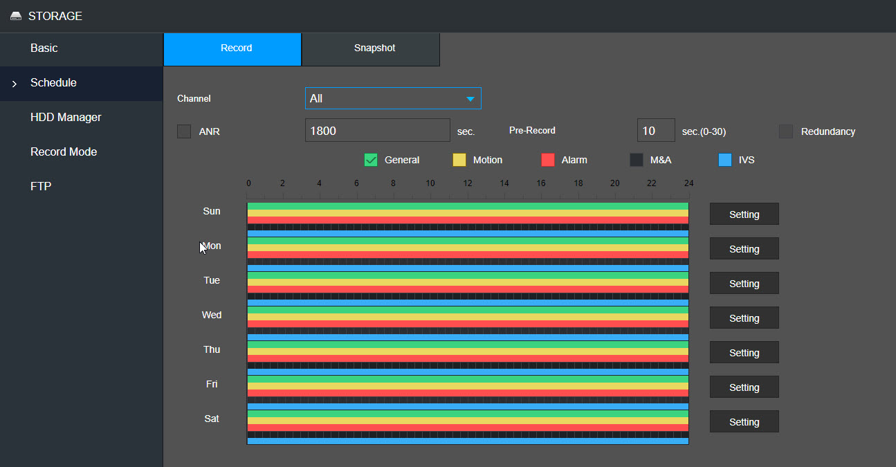

I've scheduled Alarms to be recorded 24x7

But, what I'm really trying to do is figure out a way to turn on alarms so I can get 1fps general, and 5 fps for IVS/Alarm.
Since my only recording type options are:

But for the life of me, I can't figure out how to get the Alarm to go off. I even enabled Video Tampering, but the yellow motion detection bars show up in the timeline instead of the red alarm bars.
It would be great if I could figure out how to get the red alarm bars to show up in my timeline.

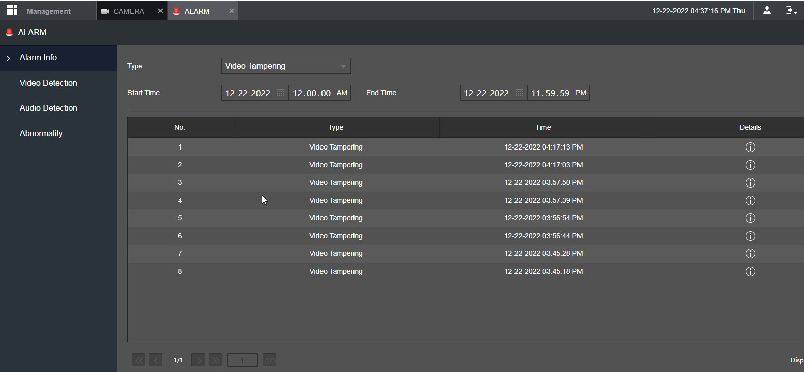

I'm confused why the Video Tampering Alarm is showing up as "Motion Detection" in the timeline (Yellow instead of Red)

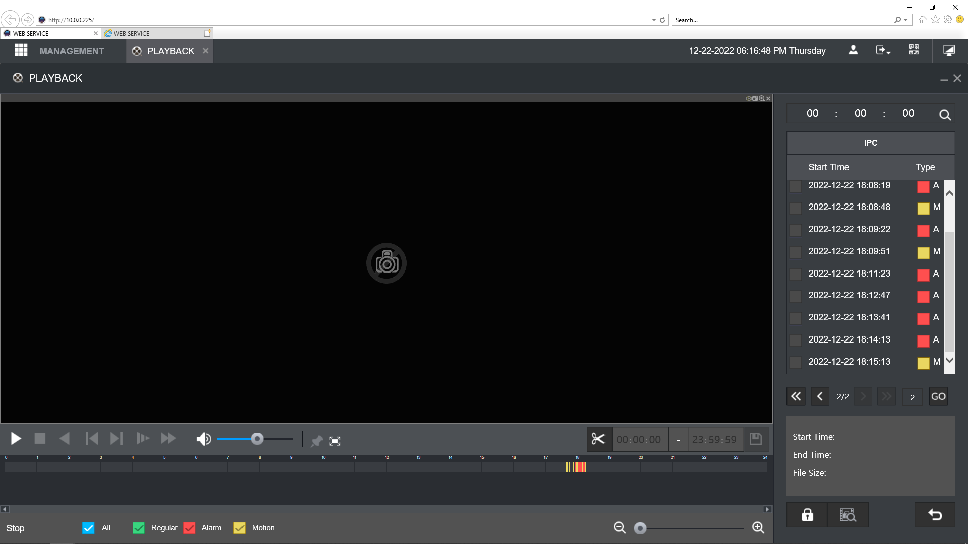

Wow! The red bars show up for you!
What type of events are the red alarms for you?

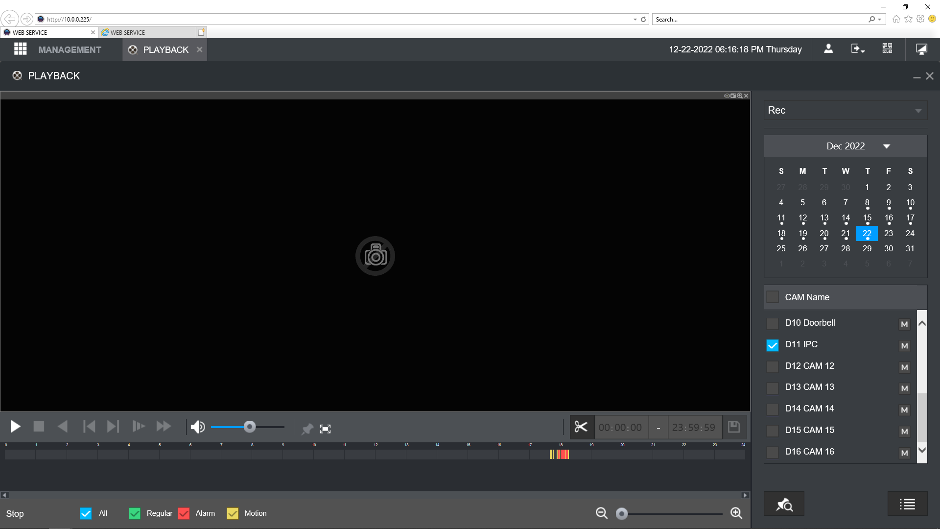

Yeah so that is why I wanted to do some more testing.. So after some deep testing and this includes Formatting my HDD, Reset the NVR back to Factory, and setup of 2 cameras I had 3 events come up again with Alarms however I thought I better remove the Audio Alerts and as soon as I did that with all other settings setup the way I had it before the audio alarms the Alarms no longer came..
So I changed to a camera with SMD to see if I could get my AI NVR to pick up and save alarms for SMD and it didn't do that either..
So it seems that only way to get alarms saved is not a good way for saving IVS or SMD alerts.
So in truth you said your able to get Alerts on IVS and it works well? That is the reason behind getting a AI DVR/NVR is so you can have AI cameras setup without giving false alerts.

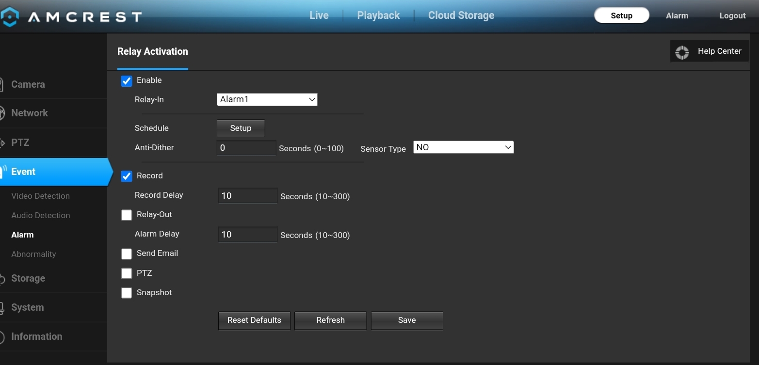

Re: Need Help with Alarms
258pearl,
This should be one way to get alarm red bars. You need to have an Amcrest camera that has external input/output ports. Your cameras likely do not.
