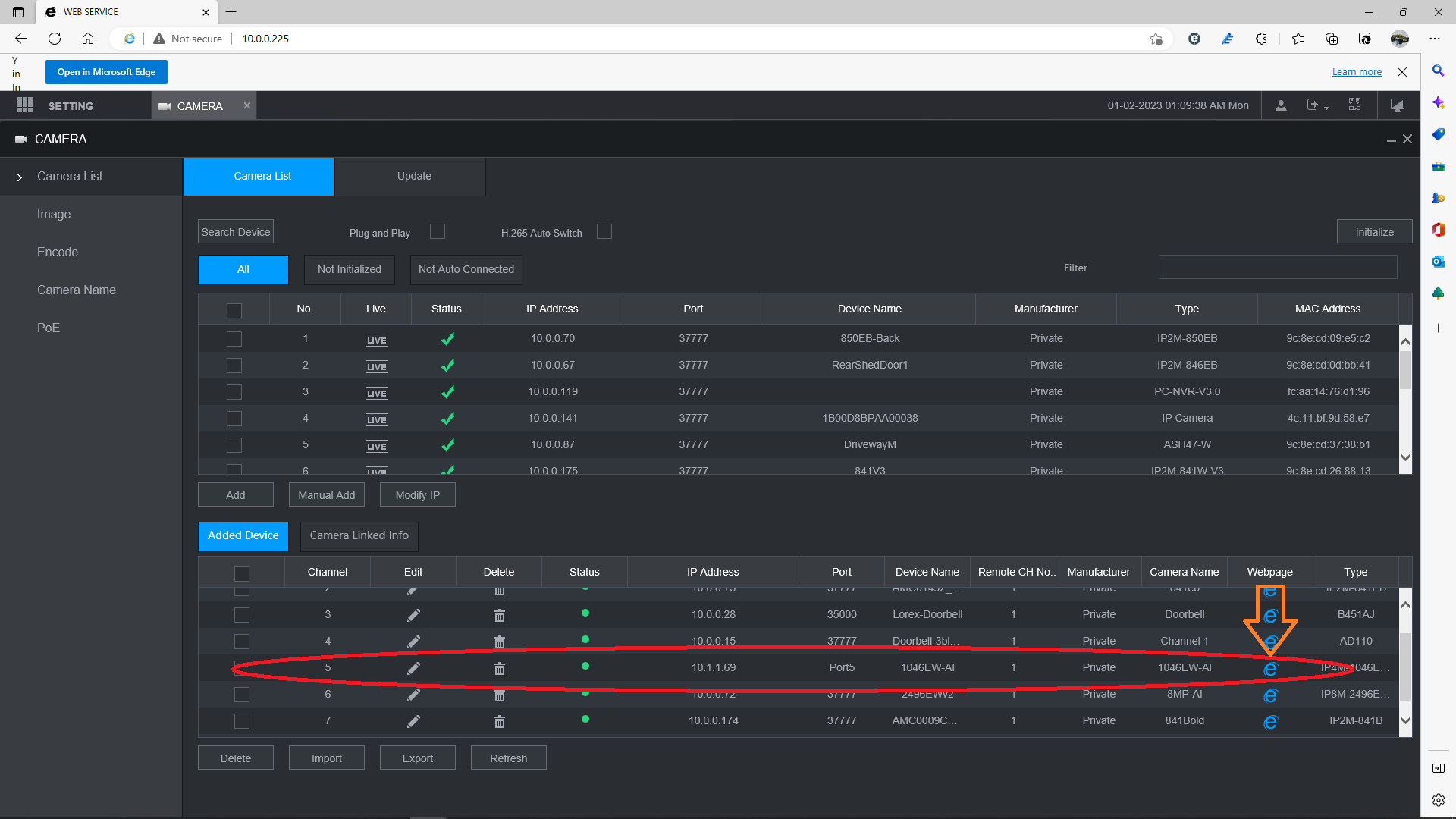

I've gone through the steps but when clicking the IE icon within the Web UI I get the camera ip but no port number (not sure if that means anything or if it needs to access the camera first then show a post (I was expecting to see 10.1.1.22:10080 or something). Here are my screen shots:
Am I missing a checkmark somewhere or doing something wrong?
Thank you again for your time on this, I appreciate it!

Hmmm So, When you log into the NVR's IP address. In my case that IP was 10.0.0.225, I then go to my cameras, I click on the e that is next to the IP address that is connected to a camera that is on my POE NVR's Port in my case Port 5. I get a IP of 10.0.0.225:10080, Then if say I was on a different NVR that has more PORT connected cameras, If I have more then 1 I want to connect to, when I click on the one for port 3 it would come with the IP of 10.0.0.222:10080 and then I want to make a connection to one on that NVR's PORT 8 I would get 10.0.0.222:10081 unless I only clicked on the camera e for port 8..
If you click on a camera that has a normal IP like inmy case you can see in the picture other cameras with 10.0.0.xxx range it will open a new tab but will be under that IP..

1, your IP your connecting with is 192.168.30.87 and when you do so and then click the e to the right for the port your trying to load. Your NVR should try to start at 192.168.30.87:10080 or some other port number no the IP address for the camera. You have to click the e on the right to bring up the Virtual Host Port adding address to your NVR or it will not connect.
Also in your Settings, I would look under Network to see if there is a Virtual Host button that you will need to Toggle on? IF there is one turn it on. Might need to look if there isn't one however because with that being in the Ultra Class of NVR's it might not be on the Main Network page where the ones I have with the OPTION to turn on or off it is under my normal Network area in settings...
