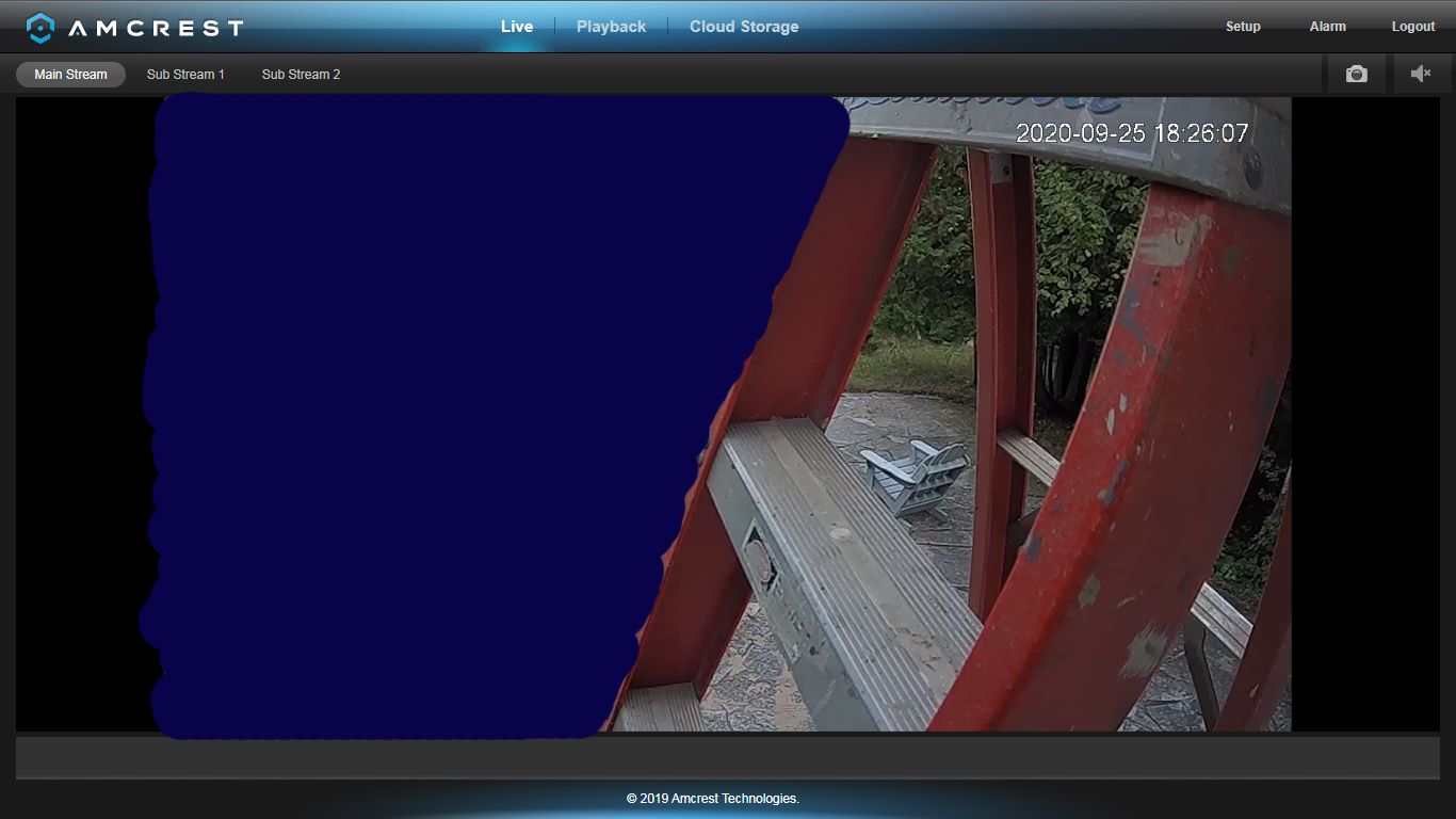

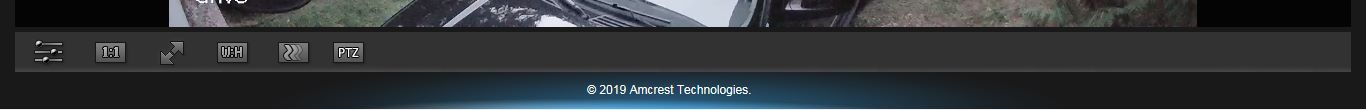

Where are the controls in this screengrab from an IP8M-T2499EW with the "new" firmware, viewed on a PC with Chrome?
Re: Where's the controls?
They were eliminated. But remember, you no longer have a plug-in!

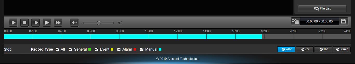

Here's the reply from support, missing the question:
Question: I have several of this model, one I just installed has newer firmware and no way to play back or download video from the SD card on a browser (chrome). Several other controls are missing, like full-screen, Fluency, etc.
I access my cameras remotely by PC over LAN but often by WAN from other cities.
Tech Support Answer:
We always recommend to factory reset the device after firmware update.
What is the status of SD card?
Thank you & Have a great day
Um, no.
Um, no.

Well I can tell you that doing a Reset after a FW update is kind of needed to flush out older info.. Case in point.. I did an update on my AD110 and even though I did a Reboot x2 and a Reset for some reason it didn't really reset the camera and when I did a Config back up I had over 2000 lines of trash in the camera I know this because a week later after doing yet another Reset this time the Reset took hold and rather then having 7575 lines in my Config Back up I only now have 5342 lines in the Config back up taken by same method of backup...
So While I can't say it will correct your issue I wonder if the Controls that the Camera or NVR is looking for is from Old Method and with the NEW FW install by doing a Reset would FLUSH out the Conflicting Code that is making so your Controls are missing????

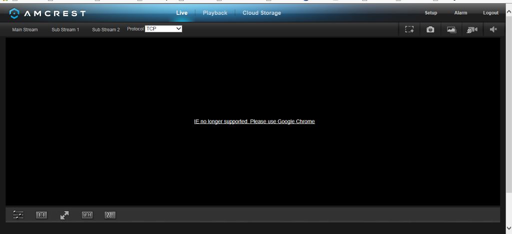

Interesting note; when you try to open the new FW camera in Internet Explorer, the missing controls show up but are inoperable.
