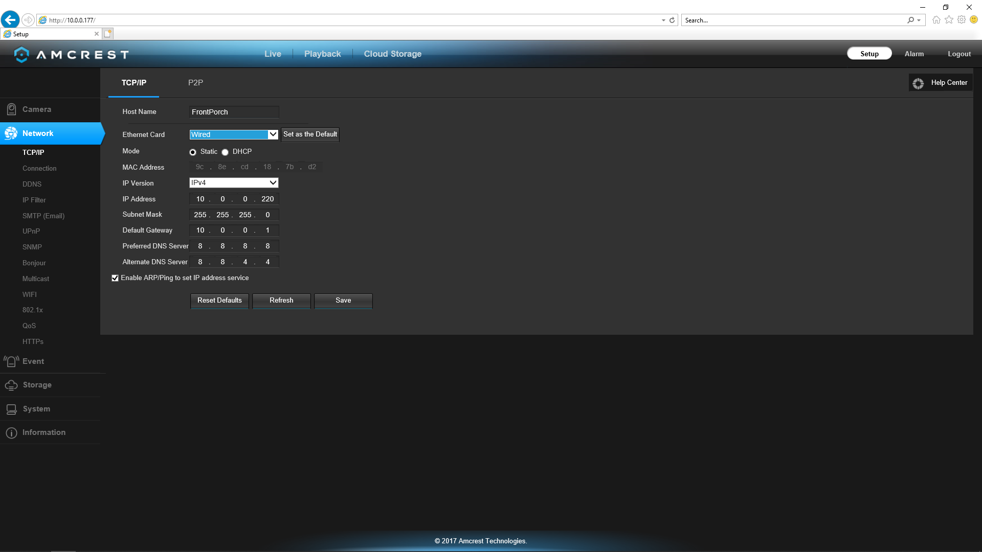

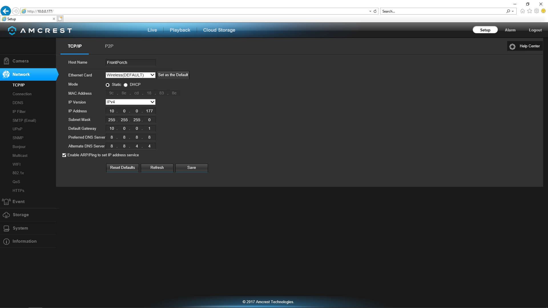

Thanks for the thoughtful reply. When I log into the camera using IP XXX.XXX.X.116 and go to TCPIP, wired is in the window and the IP address is XXX.XXX.X.108 which is also the IP address of the NVR. If I change to wireless, the IP changes to .116 which is what I use to log in to the camera. "Save" executes. BUT, if I look at another page and then return to the TCPIP page the Wireless has been changed back to Wired and the IP has been changed back to 108
Second if that didn't help by changing the Default to Wifi then again log back into the camera, setup, network, TCP/IP and if you changed to Wifi as default then click on the box and bring up the Cable (Ethernet) access part and change the IP to something your system isn't using then save.. That will cure the issue of it coming up with wrong IP to the 108..
I don't understand "click on the box and bring up the Cable (Ethernet) access part". What box?

Re: NVR Not Recording one Camera
Ok first when you click on the drop down like I show in my pictures you can see one says default over the other. When you set it to default (wireless) it will start out on that setting from then on.
Next change type in the wired menu to static and put in a ip address that won't conflict. However it really shouldn't matter my guess is the ip in your setup with .230 isn't used, so I would set it to that static ip. 192.168.1.230. Will have to change from dhcp to static and then change the ip away from 108 as you need.

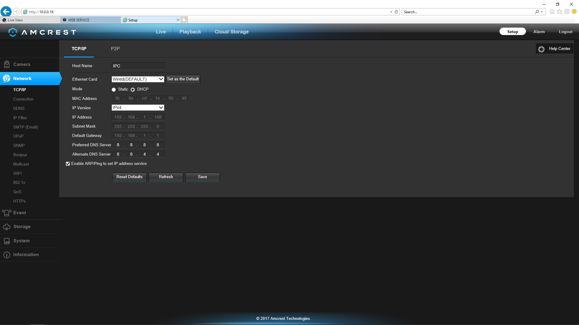

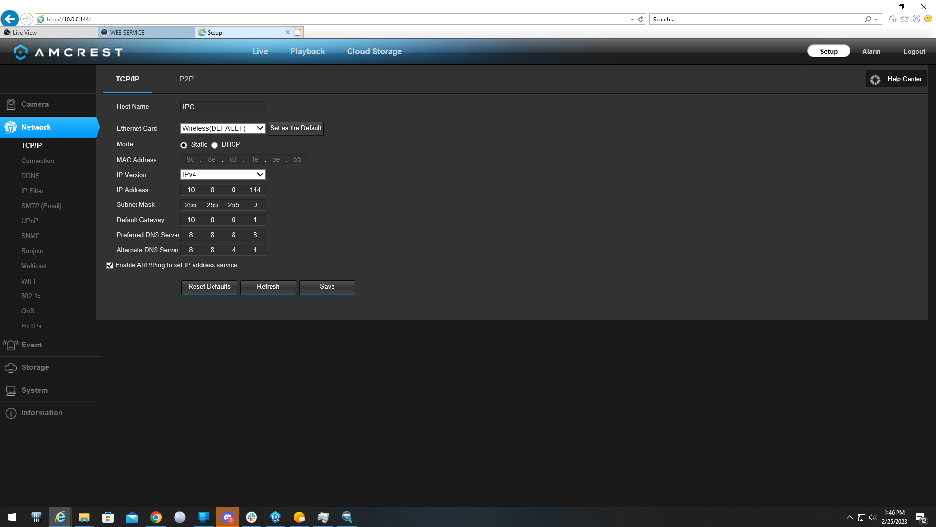

So took one of my 841 that is setup like my 941 and reset it to factory. This camera won't work in Ethernet because I removed a part of the circuit that allows that. However the camera still offers the info in the Networking area.. Looking at the pictures below, You can see that Ethernet option was set to Default by default settings, Then in that camera that is the default IP address that it was given when I reset the camera. Then looking at the IP of the wifi it was showing and I was connected to .19. I did change that to .144 and I changed the Connection type to Default for Wireless now when I startup the camears WebUI and I go to the Setup, Network the first set of numbers now shows the Wireless and not the Ethernet like it did when it was set for default..
OK, I see how to change the IP address. But I set Wireless as the default , do a "Save", go look at a different page then return to the TCPIP page, the wireless is set back to wired. I guess at least I don't have both the NVR and the camera on .108

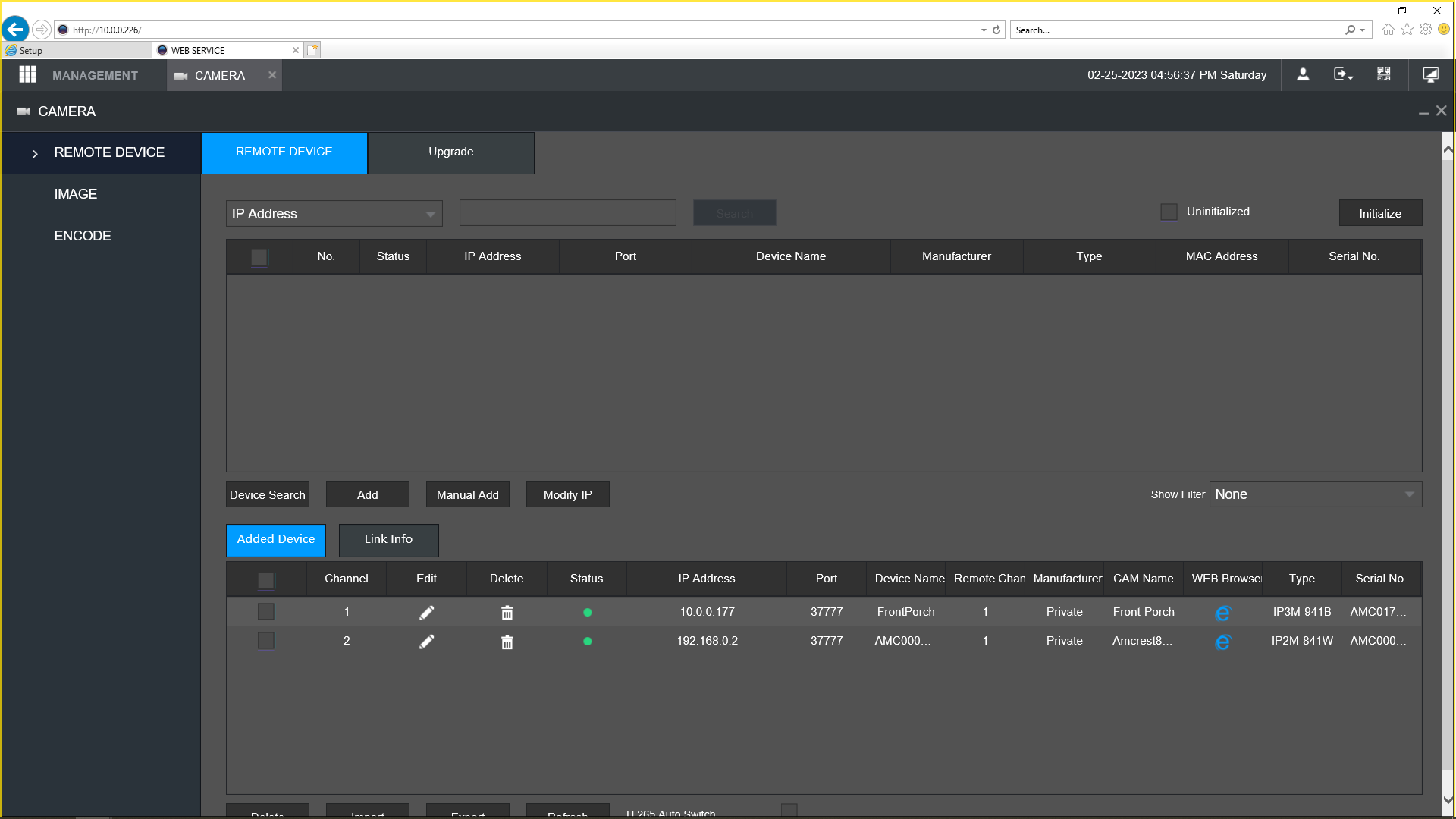

One more issue. I can't get the 116 camera to record. It shows up in the NV4108-HS camera list but it is not online. The other cameras have a green dot, but 116 has a red dot.
Regards, Jim
Regards, Jim
So if your camera has a red/orange dot there are a couple of things that can be at issue. One the IP and port are not right for the setup. Another thing is that the Password for the device could be wrong..
So using 4108-HS and or any of the DVR/NVR's it is really best to do one of 2 things. First change password to the same one as your NVR and load from the camera page on the NVR's GUI. Not always but sometimes if loaded from the Grid, or from the WebUI of the NVR it can for some odd reason just default to the admin password. So by having the same password as your NVR normally it will just load it in right away. However in the Event that when you add the camera if it don't get the green dot right away click on the Pencil and change the Password for the camera to the one you know is the password for the camera.. Then it should go green and let you see live view..
If that don't work and the screen says that the NVR is locked out then you will need to power cycle the camera. Sometimes you can get away with just doing the NVR however most times it isn't locked out by the NVR but the camera so best to reboot the camera.. Once the camera comes back online it should get green dot and load up on your NVR..
So this is a picture of one of my 4108-HS nvr's with 841 and 941 cameras on it for this. While I normally say the cameras should be on the same network range This does show that one can use the NVR to load cameras from more then 1 range. It can change the quality of feeds the same goes for having it connected to more then 1 device. So if you have it streaming on 1 NVR while on ASP and WebUI and your phone things can tax your network and slow things down.
Well I don't know why but I double clicked on the "found" 116 camera and it was added to the camera list at the bottom of the page. When I deleted the second copy, the first 116 turned green. And the camera is now recording.
