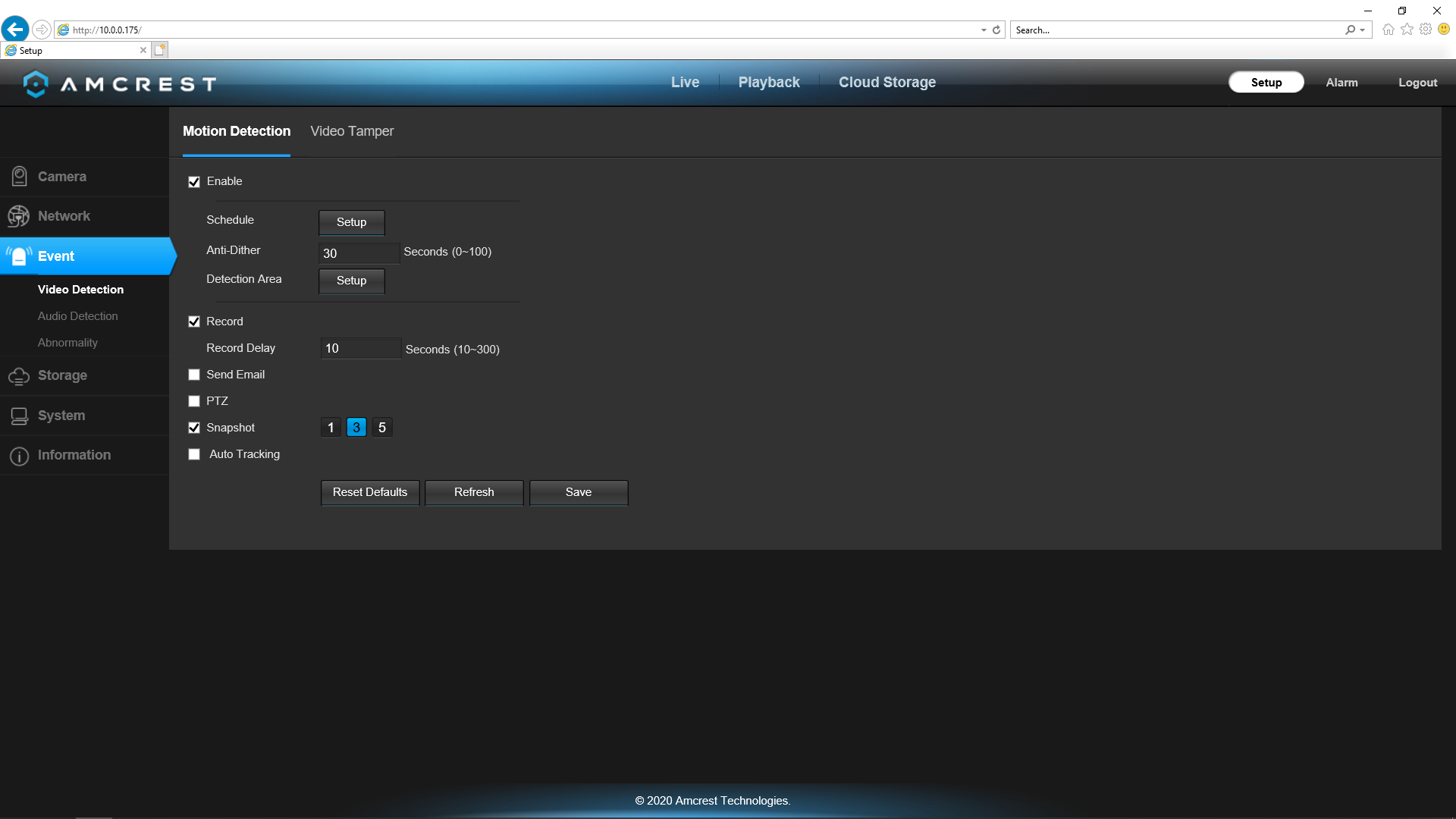

Now about the camera being on Auto Track, It don't come up with it setup that way. It would have to be turned on. You can see it in the picture below just above the Reset Default on the page.
