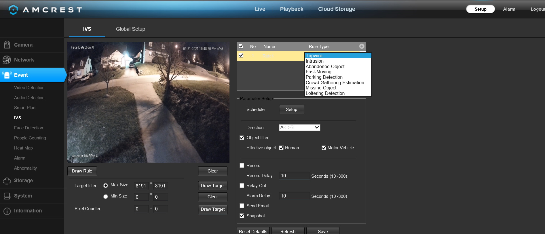

My camera don't have any IVS rules right now seeing I have it setup for Face Detection right now however the Picture below is where you would setup your rules within your camera

Sorry it didn't finish the text or it got deleted when I put in the Picture.. Anyway under the area after you put in the Rule you can click on Human or Vehicle and setup the record time once triggered...
