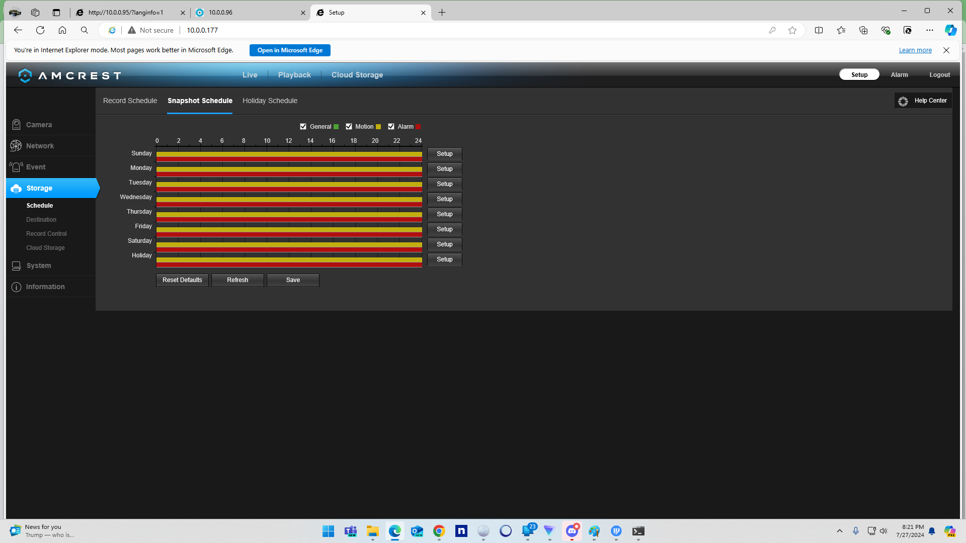

So you will want to double check that your camera is setup right. Some devices by default have full time video and snapshot setup.. So I don't remember what ones do what. i know that all my DVR/NVRs for sure are setup out of the box that way. You will want to look under your Schedule under your Storage. Then change all your full time recording to motion if you only want motion or alarms. There is also a Tab there for Snapshots make sure all days are setup for motion and alarms as I have setup in my picture below.. Only thing I can think of outside of Manual recording settings and not setup for auto.. If you pick manual it will record and snapshot full time..

I went under Schedule > Storage and changed the Record Schedule to MD only for all days. Under the Snapshot Schedule tab I turned off all settings........and the problem still persists.
