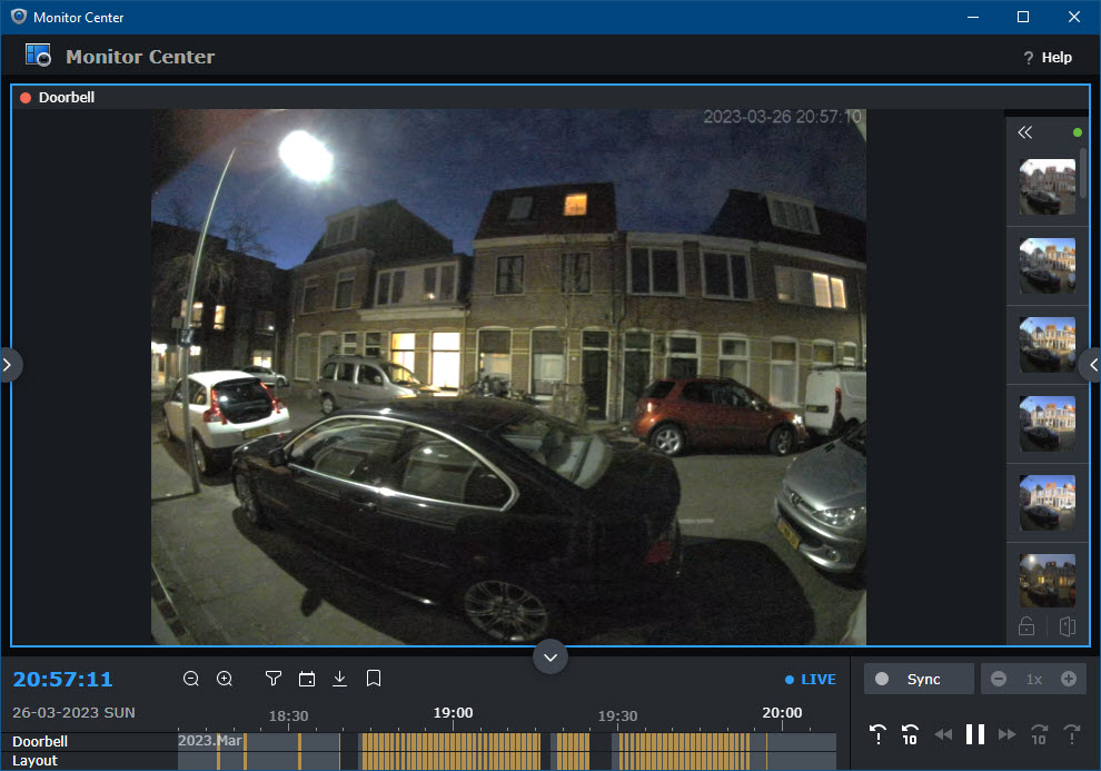

I got a new modem from my ISP. I ensured that the IP address did not change and I even saved Wifi settings again just to be sure. It was fine for the first few hours or so, but the image would distort every so often bad enough that I decided to reboot the doorbell more than once, well that is when "ghost detections" started, exactly a minute apart
I have done everything except a hared reset, which I want to avoid if possible because I can't get to the button on the bell easily.
I have disabled Motion Detection on the AD410 and set Surveillance Center to detect motion, which works well enough, but not as accurate as "by Camera".
Any idea what it could be?
AD410 detecting motion once every minute

It's not as upsetting as it could be. I messed around with some hhtp level commands to try and change some settings not available in the Amcrest Windows client and Android app (ages ago) and it resulted in the picture stuttering every few seconds, it is very minor, but noticeable and I read that to fix it I would have to hard reset, so now that I have two issues, I guess I am hard resetting the doorbell tomorrow!
It has worked fine for more than a year connected to my Synology DS720+ NAS on Surveillance Station. I balk at resetting because it wipes recordings in the NAS, and I can never get the older recordings added back to the "newly connected" same camera.

Well, I left it like that overnight and this morning I set Event detection back to "by Camera" in SS and it is all working normally again. Even the stutter every few seconds is gone. I guess rebooting it a few times helped yesterday.
"By Surveillance Station" sucks because it detects any changes in light, and I do not understand what values to set the "Sensitivity" and "Threshold" (with my previous Hikvision doorbell) it's either too many false alerts or none at all with SS setting.
I may have also reset the http commands that I did earlier by toggling wide view on and off, which may have reset the stream picture quality.
